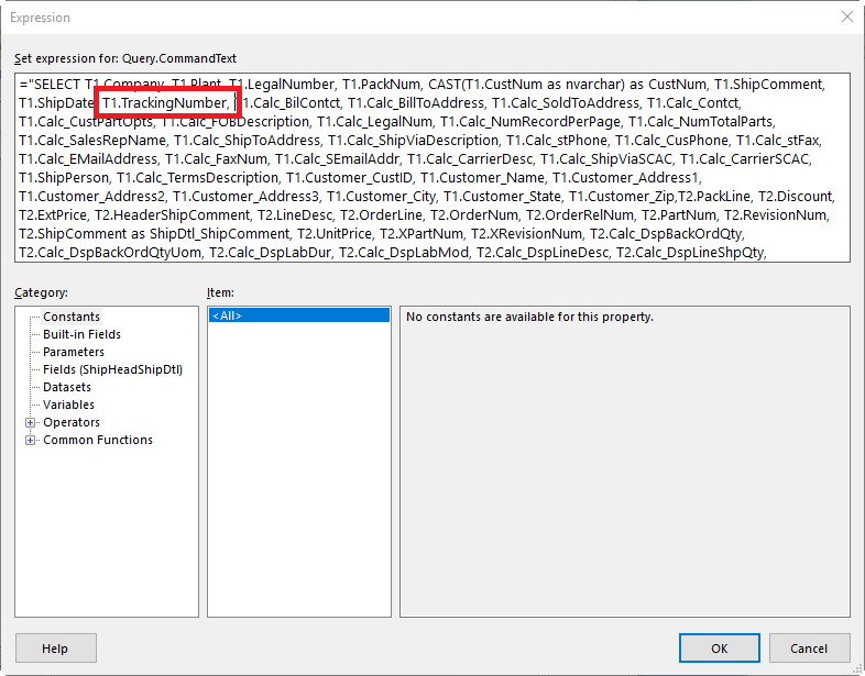

How to add the ShipHead.TrackingNumber field in the RDL file?
I tried the “Add calculated field and editing the dataset query” method, but no luck.

Pressing the “Synch Dataset” in Report Style Maint always gives me the he-be-jee-jeebs.
Add T1.TrackingNumber to the report Query…
Then add Query Field to DataSet…
That is exactly what I did.

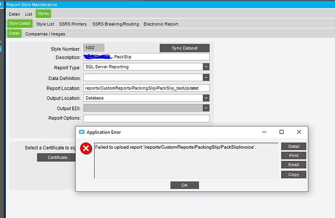

I have followed this and have come to a problem, when I when to Sync the Dataset, I got the below error.

When uploading a report, you need to point to where the “reports” folder is on your local system.
Don’t browse to “…/reports/CustomReports/PackingSlip”, just point to “…/reports”
And it looks like you downloaded a report and made a local copy. I’m guessing this because the upload process thinks the appropriate file is named “PackSlipInvoice”, and you want it to be “PackSlip_test_updated”

The Report Data Definition was changed and when I when to “Sync Dataset” is when I getting the error.
All of the Reports are Server based, none are local.
The “Sync Dataset” function really shouldn’t be used for customized versions of built-in reports. Only for BAQ Reports (and sparingly there).
The Sync Dataset basically re-writes your RDL, updating all the data sources and queries, often renaming a lot of fields. It breaks reports more often than it fixes them.
