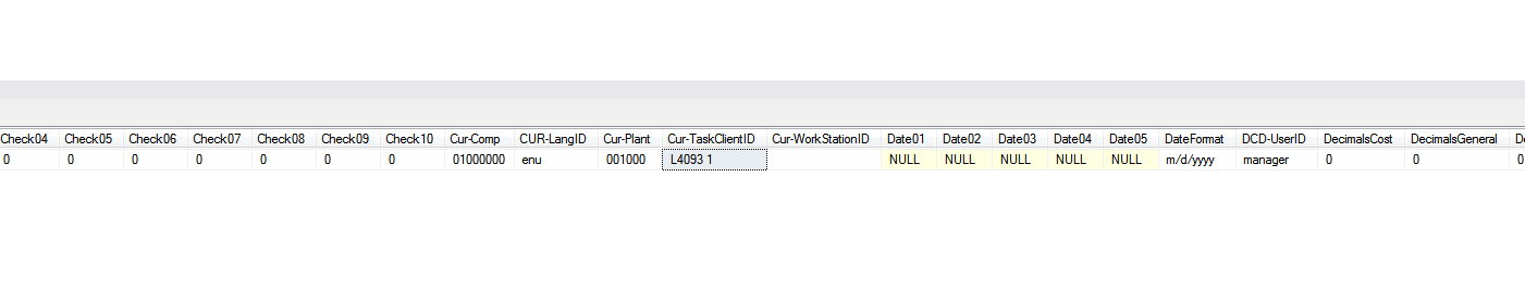

If I look at the SSRS BAQReportParameter table, this is what it has when I run it through the Client…
I wonder what REST would be doing diff.

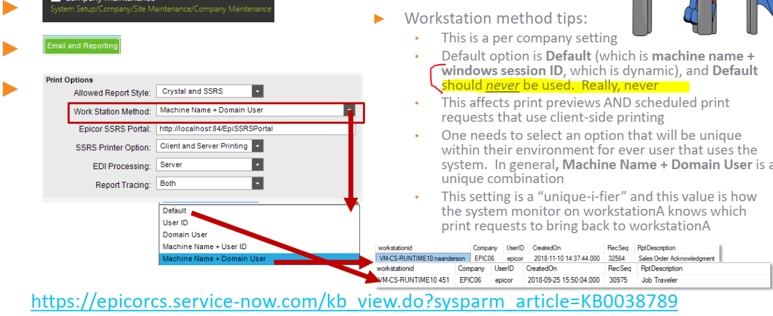

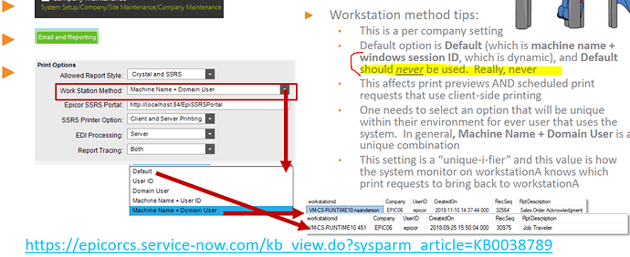

Correct, it’s actually the ClientComputer name plus the session #… so if you were logged in twice it might be 1 or 2? Per your example, and mine followed this as well it’s L4093 + 1 or 2 etc… I’ll need to dig into that a bit further.

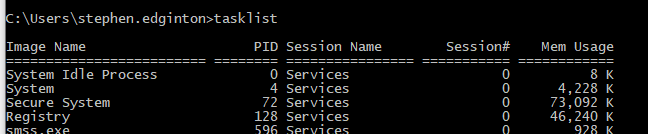

This is configurable note that the session ID is actually the session you see in windows image
This is such that on a terminal server the same named user (say with MES) does not get others print outs.
However it is configurable and you can hence tweak how things work for your needs
image image

Basically what that setting does is when you Submit a Queued Job to the Agent, it knows where to send the ex PDF Preview too. Imagine if you have a Terminal Server (Citrix, RDS) you probably have 30-50 Users Connected, it determines where to send the result to. Have you ever been connected to 2-3 PCs with the same UserID and you Print Preview something, it doesn’t show up, later you login and they all popup.
