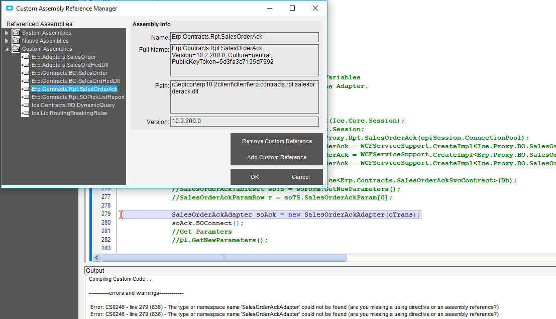

Does anyone have a simplified example of printing a ‘standard’ report through code, in 10.2?
I have a ButtonClick customization that launched a report in E9, but the code conversion to E10 has rendered it non-functional. The ‘usings’ have all changed to Ice (appropriately, it seems), although a trace of the manual report execution reveal calls to Erp.Proxy.Rpt.
Anything identifying the proper using directives or references and perhaps the objects to be instantiated would be appreciated. Guessing just isn’t producing results for me.

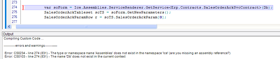

Aaargh!
So it appears “Ice” doesn’t contain “Assemblies”?
I should have asked where are you calling this? Which form? That might have been a good start. lol

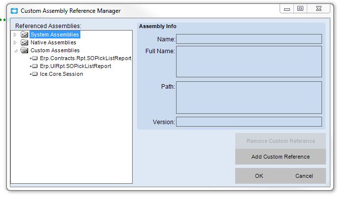

Think you need to add the assemblies.
Here is a customization example on a dashboard. Another report but same concept.
Add Assemblies. You will need the SalesOrderAck one not the SOPickList

Hmmm. I seem to be hitting the same brick wall, but from different angles. Can’t seem to get the correct objects instantiated, and I’m not aware of any documentation that lays out what is connected to what…

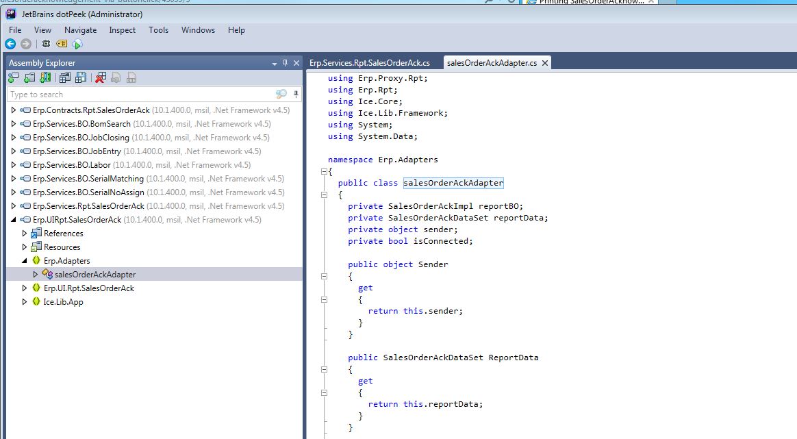

Yeah, I thought of that, Ken. I’ve tried adding all sorts of references and using statements to no avail. Given the few clear success stories online, it appears that printing programmatically has gotten a bit more difficult with E10. I do really appreciate your taking the time to help…
try to declare the field like note the lower case s.
salesOrderAckAdapter p2 = new salesOrderAckAdapter(oTrans);

@knash, you nailed it with the lowercase “s”. I’m elated and frustrated at the same time as everything that Epicor automatically inserts into the script capitalizes that first character! Even the name of the DLL is capitalized! There’s just no rhyme or reason.

It is lower case in the dll. Sucks that you have to take a peek at the code to find that out.

Works a charm - only needed to add reference for the Erp.UIRpt.SalesOrderAck.
