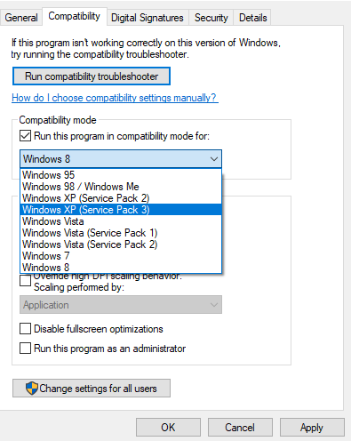

Is the Vantage client running on the affected machines in Compatibility mode?
yeah, tried XP SP3 and Win 7 compatibility modes.

set the V8 client shortcut to run in compatibility mode…

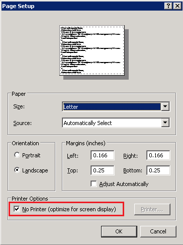

I’ve had issues where a Crystal report has printer specified in the page setup.
i.e. some clients were not able to connect to a network printer
So… I go to Crystal Developer page setup for all custom reports and specify “No Printer…”

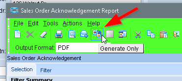

If you choose to generate the report - this is different than printing or previewing - does it still shutdown?
I forget what V8 print windows look like, but here’s an E10 one:
Thanks for the prompt reply.
Yes, the client shuts down. The server doesn’t crash.
I just tried a generate only and it did NOT shut down the client.
It seems to generate the report and if you are doing a preview, sometimes you can actually see the report preview for a split second before the Vista client session shuts down.
