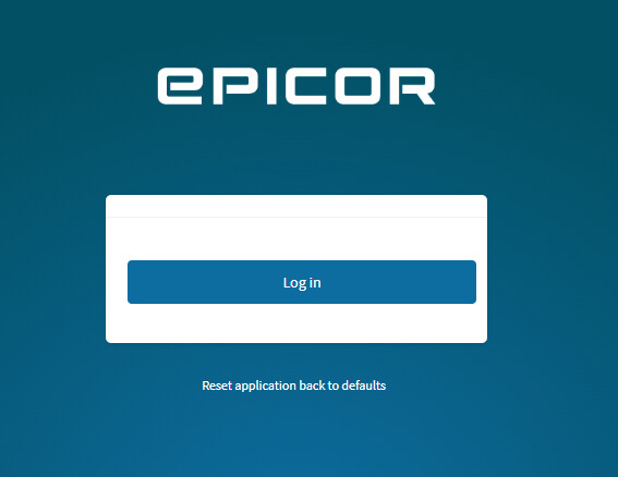

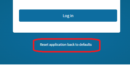

The “Reset application back to defaults” is a cheap and easy step that MOSTLY clears cached items. Epicor does NOT (at least that I’ve found) describe in detail what this does, but it often fixes cache issues in my experience.
