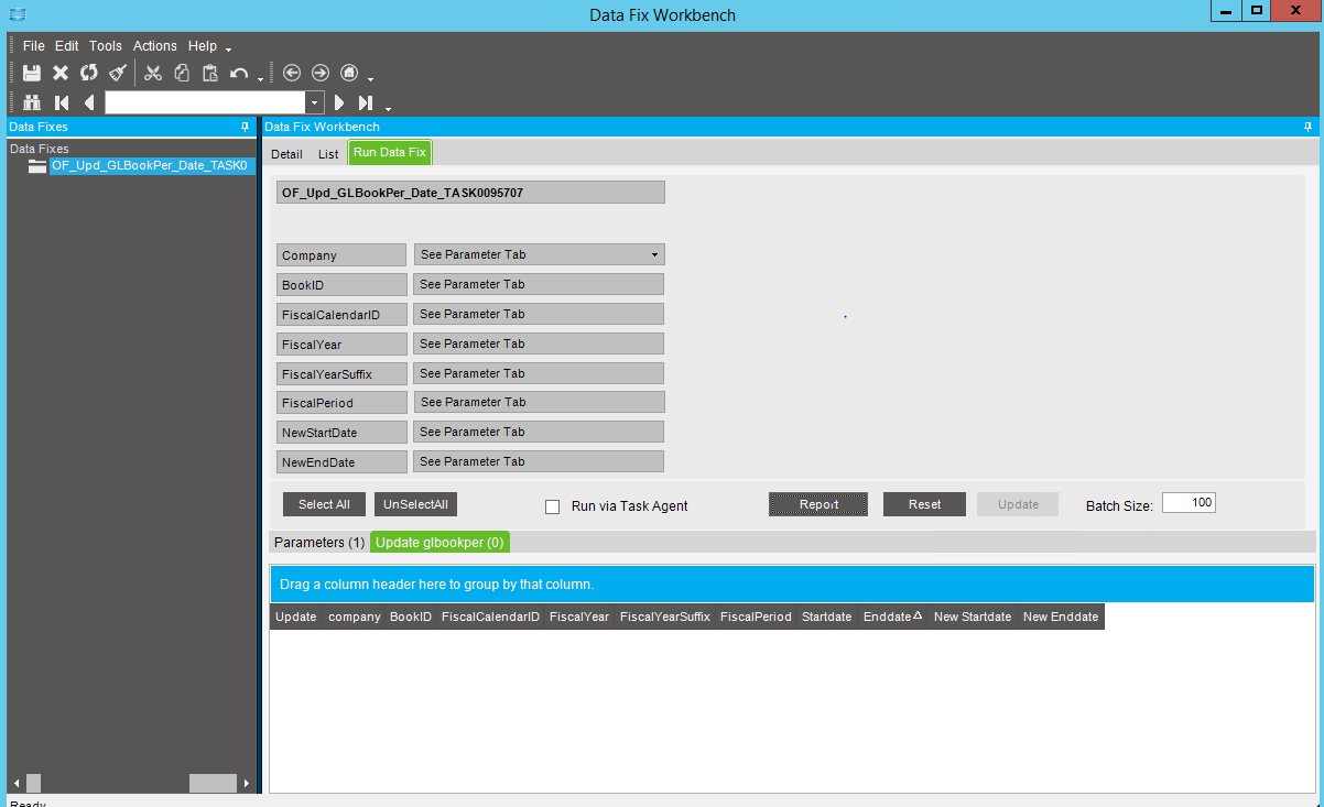

However, the GLBookper tab does NOT contain the line I want to update, even after hitting “Report.” The “Update” button appears unavailable:
Am I using the workbench correctly?

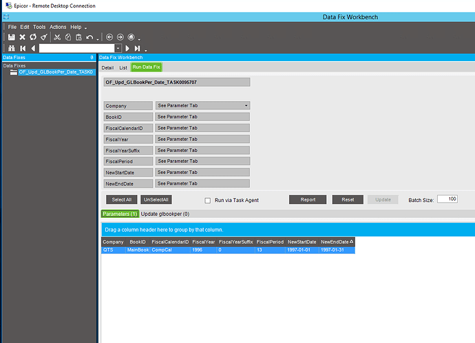

I would double-check the parameters. It looks like you have a “0” entered for the Fiscal Year Suffix. Is this the actual suffix, or can you clear this parameter so that it’s blank?
Since you’re not getting results when you click Report, the parameters you’ve entered aren’t returning any records after filtering.

You have Parameters set in this Data Fix according to your picture above.
By hitting ‘Report’ you are asking the data fix to search for whatever the parameters set by the data fix. If it finds zero entries then there are no results per the parameters.
If you’re expecting results and know an entry is incorrect that is supposed to be fixed by this fix then you have to call Support and report that the fix is not finding the issues the fix is supposed to correct.
OK, so the newest data fix cleared the 0 out of the suffix in parameters but when I click report, I still get nothing. Do you think this could have to do with the start and end dates of the fiscal period being outside of the fiscal year? Our prior accountant entered a 13th period with a start date in 1997. It is this odd 13th period that we don’t have an end-date for. The existing start date is 1/1/97 and Epicor suggested loading 1/31/97 as end date. Are these dates incomparable with fiscal year? I’m trying to work with the limited info helpdesk is giving me…

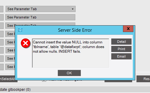

when I try to run through task agent I get this error:
3
When support saw this error running the first fix, they sent it back to development.

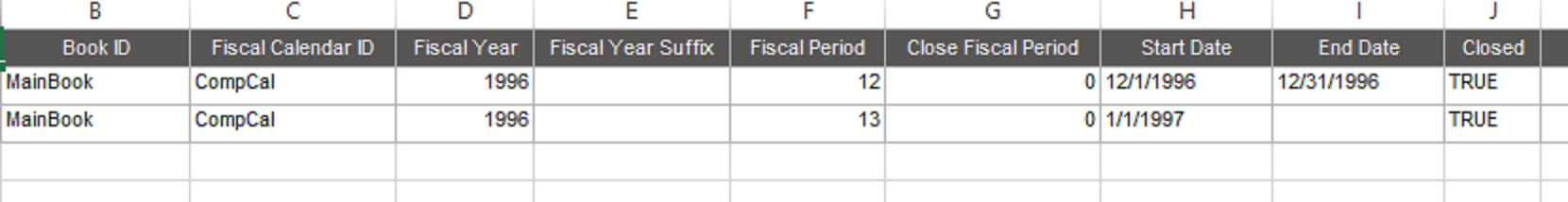

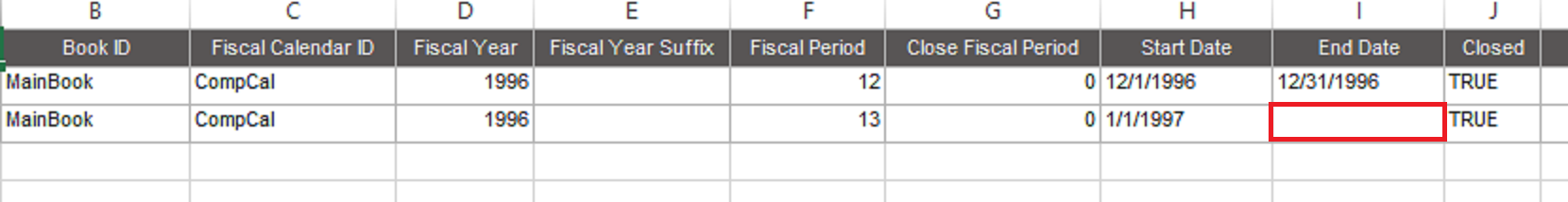

Yes. Here is the query for the fiscal year 1996 from GLBookPer table:
so would I be correct in thinking that these parameters would not bring back my problem row, because the value for end date is null in our database but has an end date per the parameters in data fix?

My understanding is that this fiscal period 13 has no value entered for end date.
Do you know why when I open that fiscal period back up, I have no access to enter a close date manually? I’ve tried but Epicor doesn’t allow.
