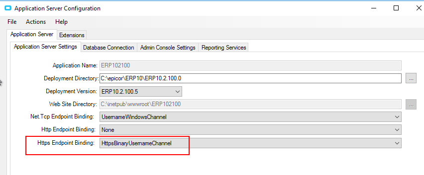

Support feels they have narrowed it down to a permissions issue with the Token Authentication permissions, and we tried to login to the TokenResource.svc via browser (https://(Server)/(Company)/tokenresource.svc) using the Domain Admin credentials (which is what the Epicor App Pool is running under) with no luck. Any ideas or help would be appreciated.
Where are the permissions for the TokenResource.svc handled?
So I had a look, I think I see the issue. Normal REST stuff falls under its own umbrella (therefore it handles its own https binding). The token service is not part of the normal REST interface. If your appserver doesnt have an HTTPS binding, it wont work.
That being the case, their installer should check for that as well.
