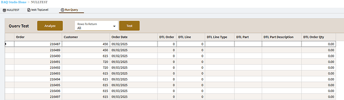

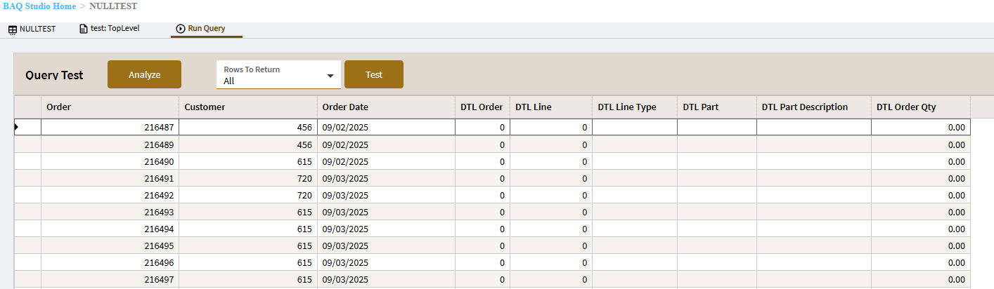

LEFT OUTER JOIN of OrderHed to OrderDtl where PARTNUM = ‘zzzzzzzzzzzzzzzzz’ (guaranteeing NULL results from OrderDtl):
Classic:
Kinetic:
That is bad.
See this is what I am saying. It is so very confusing when trying to validate the query structure to see records that literally DO NOT EXIST. Maybe need to explain this to Epicor developers.
