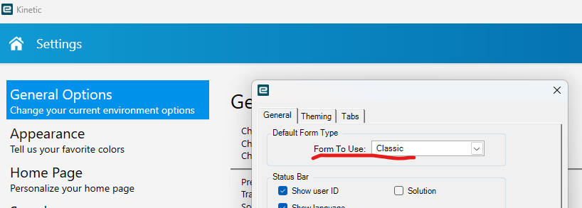

If you have your menu item set to Form to Use: User Preference, you have to set your preference to Classic
Cheers Michael :+1:

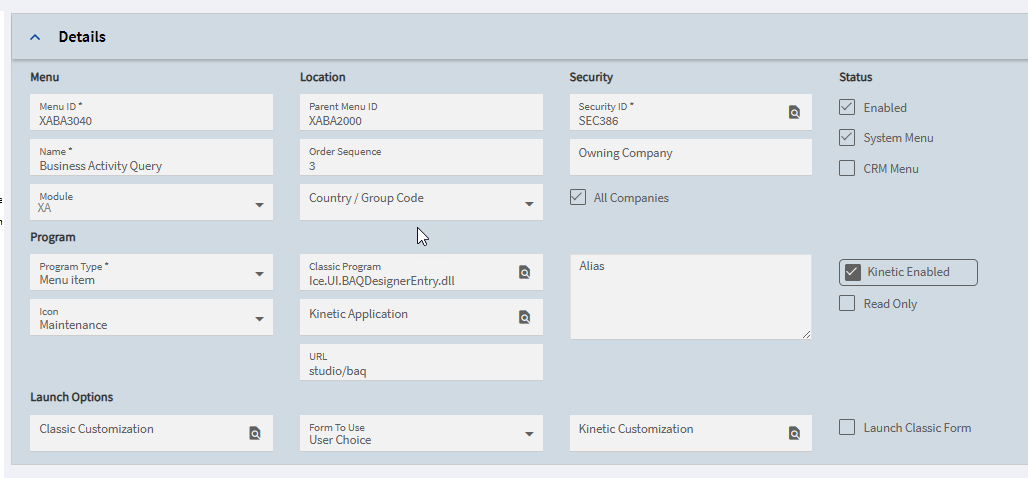

Did you log into the Classic client? If so does your menu item look like this? Also +1 to @mbayley’s suggestion.
Yeah, Michael’s suggestion worked.
