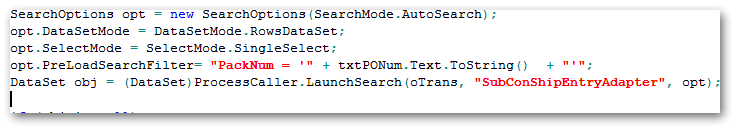

In Epicor 10.2.700.10 this code was working fine, but when we switched to 2024.2, this code is throwing the following error:
Maybe you want to use InvokeSearch, Similar to here.
@Hally , That is a good idea, but oTrans is looking at UD100 where I need to search on the subConShipEntry Adapter for a given record.
