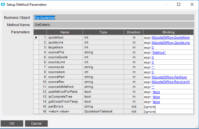

I have done this a few times - what do your parameters for QuoteAsm.GetDetails method look like? I am assuming you did a manual quote and were able to get details just fine using your No Inputs configurator?
Pulling manually always works just fine. Interestingly, I seem to be able to do the GetDetails part OK using a BPM if the part is configured using the “Configure” button on the quote. Regardless, here is how I have the method defined:

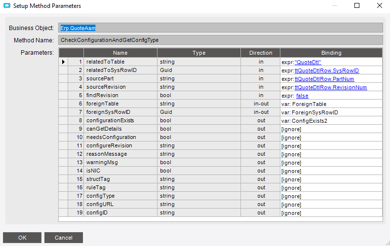

Are you also calling the method CheckConfigurationAndGetConfigType before the GetDetails?
I am and I should have mentioned that. Here are the parameters for the second call of CheckConfigurationAndGetConfigType:
ForeignTable and ForeignSysRowID point to the same variables as the first time I run it and are empty initially.

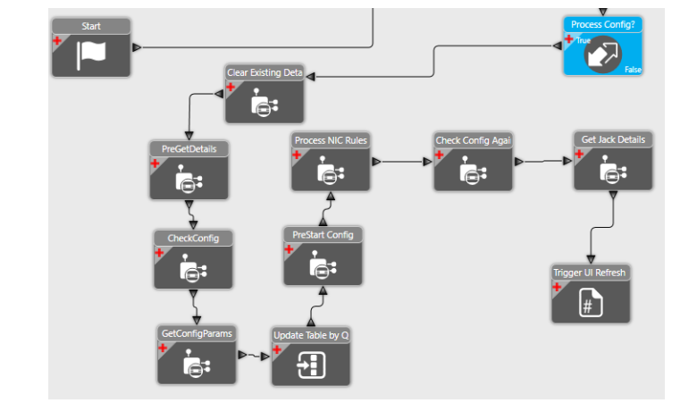

Here is the complete flow (the above is from the CheckConfigAgain block):

In case anyone is looking for this later. The issue turned out to be my not setting the RowMod properly on all of the tables prior to the ProcessNICRules method. Once I made this match the trace exactly, everything worked.
-Brad
