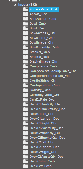

Here is our situation. We have product configuration with so much C# they often take over 5 minutes to complete the configuration of what in my expierence is a fairly simple part. There are hidden fields with crazy string manipulation calls to dozens of UD methods that access the database via Entity. Thousands of lines of code and no GUI to help navigate between method calls or intellisense to help with code generation.
My quesiton is: Is this normal for product configuration? Our Epicor Consultnat (Epicor Employee) says yes although there are some potential improvements. I just can’t belive it takes all this custom code to get drop down boxes to filter or a messagebox to tell you that a length isn’t allowed. I guess i expected a more data driven approach to filtering and controling selections.

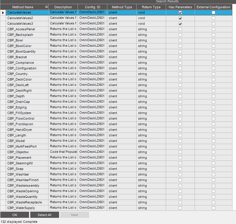

The reality is that this is unmanageable. We have 86 configurations. A single configuration can have over a hundred UD methods. Many of the UD Methods contain thousands of lines of code. With no debugger or tools to analyze performance.

My initial guess on those is that there are individual methods per combo box to determine the drop down. You may find some immediate relief if inputs are being sent back and forth between server side methods and client side methods. Assuming they are server side methods and that the inputs are being sent which I believe is the default.
Also the code snip-it you gave looks like it is only defining inputs and not actually doing anything so it’s difficult to give advise on what should be done. There is clearly some meaning with the CBP_ prefix, and if it’s just setting the filters on a combo box there are significantly easier ways to do that if it’s doing significantly more than than that my theory is shot to crap.
