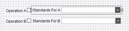

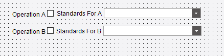

That is not the problem. I have half a dozen drop down boxes on the same page that are not related to each other. Each drop down corresponds to a different operation. If I change one standard for operation A, all drop downs for all other operations are reset to the first selection.
Also, it appears that OnFieldChange will only fire on the first selection of the drop down if populated by a BAQ. After that first selection, OnFieldChange will not fire again.
Here is an example of what it looks like…

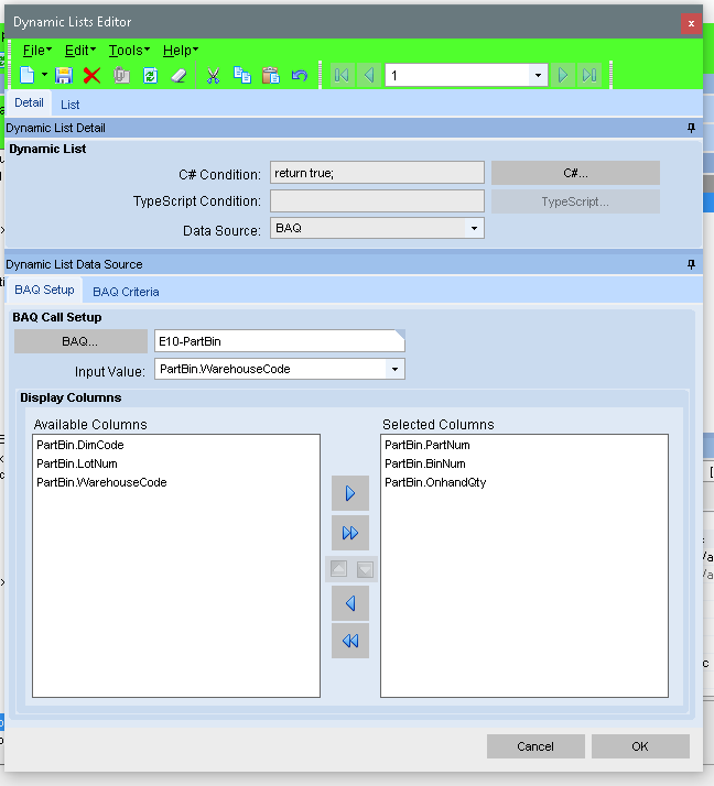

If the Input Value of the Combo doesn’t change the event won’t fire. On the BAQ Setup sheet, the “Input Value” is misleading. That’s not a value input to the BAQ. Its the value that the Input control (epiPcUltraCombo1 in my case) will have.

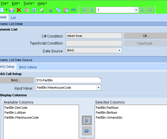

For example: A Combo with a Dynamic List of BAQ
This controls value will be mfg regardless of which entry I pick on the combo. Because the WarehouseCode is mfg on every row of that BAQ’s result.
Adding an OnFieldChange of
MessageBox.Show(Inputs.epiPcUltraCombo1.Value);
And that only fires the first time I pick a row on that combo. Because it goes from <blank> to mfg. When I pick another row, it is still mfg, so it hasn’t changed.
So if changing the selection in a drop down box does not fire OnFieldChange, then I can’t copy the selection during OnFieldChange to populate a textbox or label.
Note that when using a statically populated drop down box, OnFieldChange will fire every time a selection in the box is changed. This mean that OnFieldChange is not consistent when used with a drop down box. It functions differently depending on how you populate the box. Not good from a design perspective. I am stuck with functionality available though.

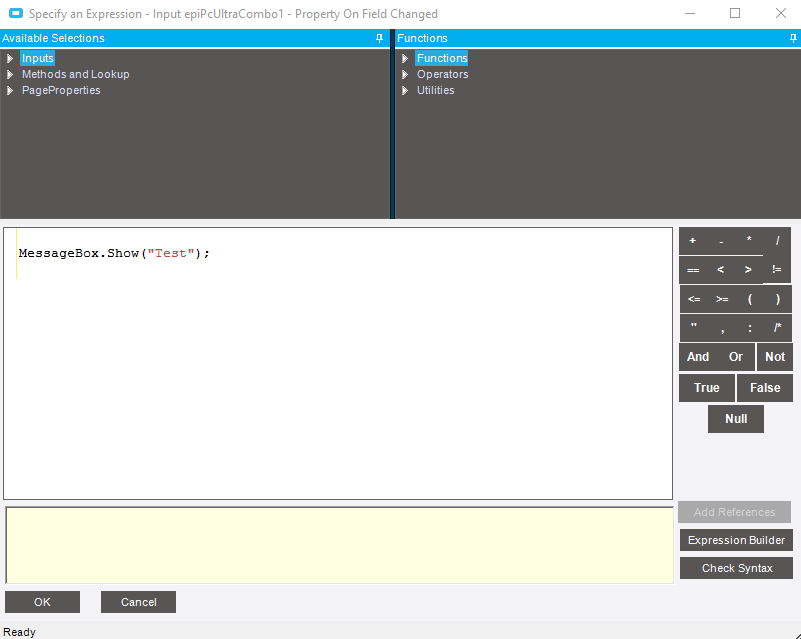

Try adding a MessageBox to the OnFieldChange event. Then test it by:
  1. Test the form, and select the first item on that controls list. You should see that control’s value. Take note of it.
  2. Close the test form
  3. Launch the test form again, and this time select the 2nd item in the control’s list. Was the same value displayed as was shown in the first step?

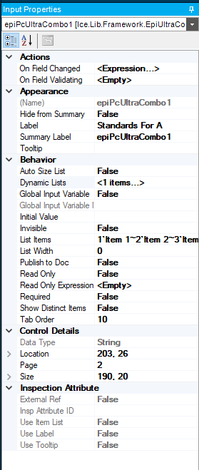

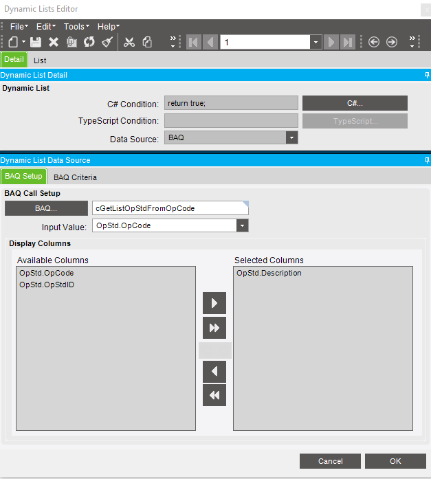

Post a screen shot of the Dynamic lists Editor window for each of those two Combo’s. Make sure to also grab a shot of the BAQ Criteria tab for each, And the “C# Condition” code (if set).
Here you go…

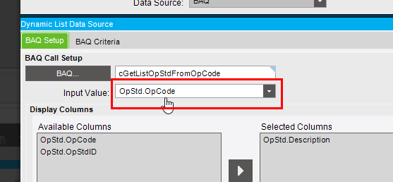

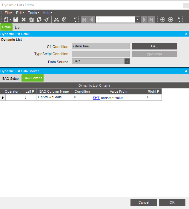

From the 2nd and 3rd picts, it appears that this Dynamic list is populated from the BAQ cGetListOpStdFromOpCode; WHERE OpStd.OpCode = SHT.
So every row of that baq will have a value of SHT for it’s OpCode column.
Now you’re setting that combo’s value to OpStd.OpCode (which is always SHT), so it never changes when you pick a different row.
Change the Input Value from OpStd.OpCode to OpStd.OpStdID
That was a long walk. Thank you!
You could also set it to OpStd.Description. Then Control’s value would match the text displayed.
Good to know. I was getting the text from Control.SelectedText.
