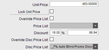

Pre Configurator being run (this particular customer had a base discount of 18%, set in Customer Maint):
Post Configurator being run (config has updated the part number, qty, unit cost among other things):
As can be seen here, the Discount Price List has been found but the discount not applied. If I check Override Disc Price List then uncheck it we get the expected result:
