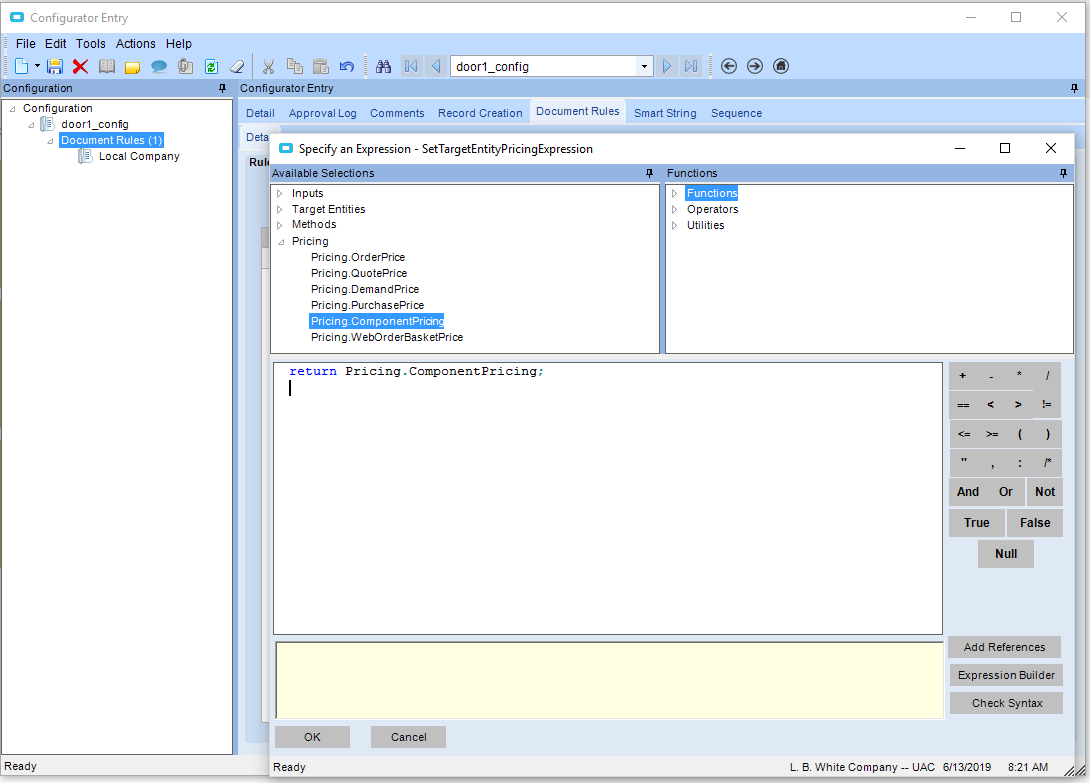

I’ve been asked if we can do a cost + for pricing on a configured item.
So I suspect I’ll need to loop through the BOM using LINQ to get the cost of the materials and add to that number. It’s too bad we can’t get at the component cost as pricing is already there but oh well.
Has anyone done this and do you have the LINQ for it? I don’t really have an idea on where to start for this and I’m relatively new to LINQ.
Most users do this in the Quote. They would do a Get Details in the Quote and after your Keep-When rules run, you can see the component costs and mark up the Quote from there. You’d have to do all the Keep-When logic in your Configurator and then get the costs through a UD Server Method.

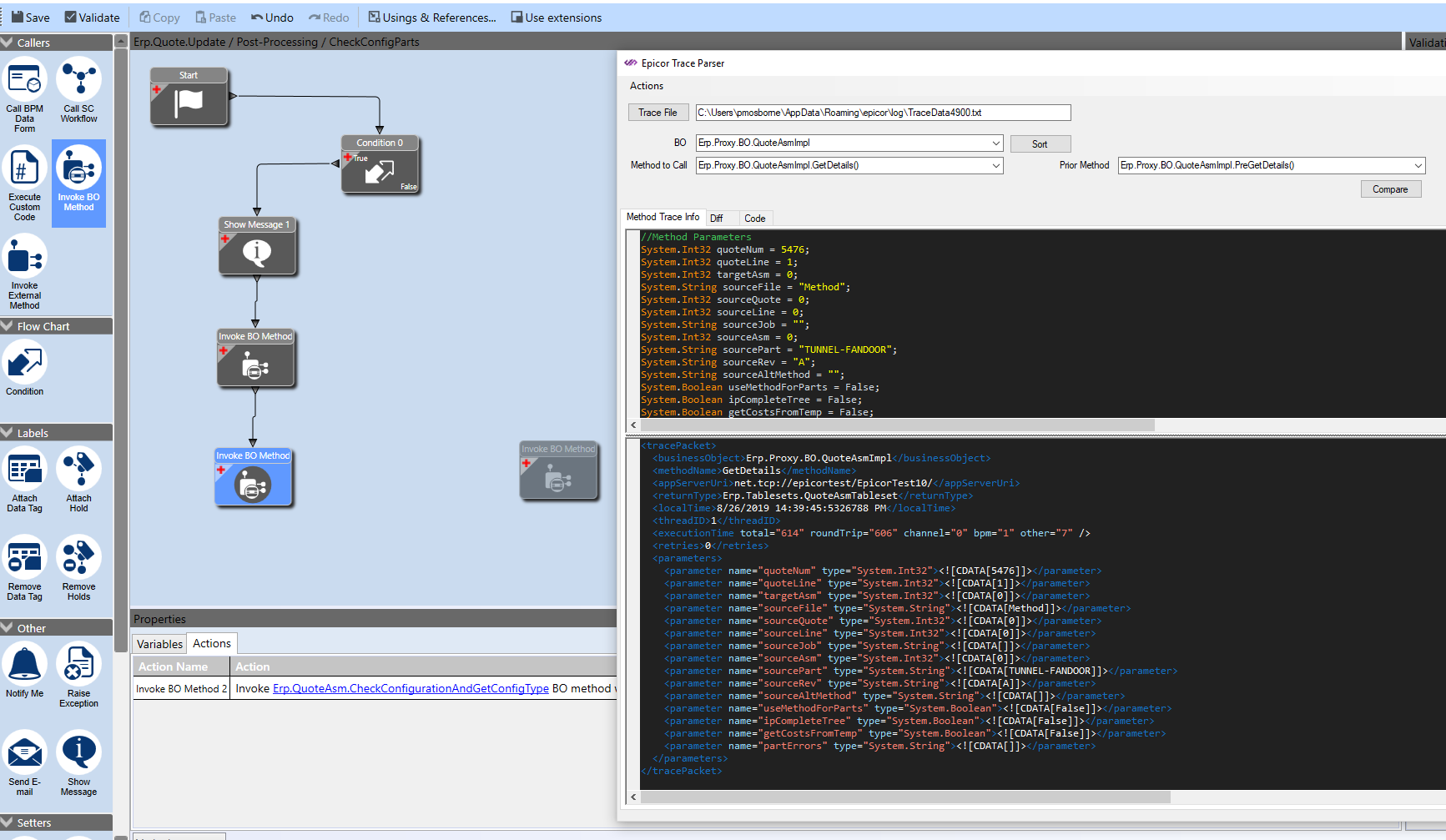

Hi Everyone, I’m finally back to to this piece. I’m able to get the standard costs out of the QuoteMtl using LINQ but only after running Mfg Details >> Get Details.
Does anyone know if Get Details can be triggered through a BPM or something else so users don’t have to do that step?
We’re trying to get to a total price calculation/field so that we can simply set the price for the line item without interaction.
Thank you
This is a little complicated as Mfg Details can ‘append’ and thus accumulate value giving you the wrong value. A proper BPM for this is on my to-do list also, but I can tell you that it :eyes: looks possible by using the QuoteAsmImpl BO and calling the DeleteAll and GetDetails methods. You can run a trace file and use @josecgomez Trace Utility to view the trace and figure out the exact calls.
That’s actually exactly what I’m working on. I guess great minds think alike :grinning:
I haven’t worked with BO methods much before so I’m not sure if I’m supposed to read in the PreGetDetails and then do something with it?
I’ll just keep pushing forward and try to figure it out.
Yes we do. I started this months and months ago, but I think I overwrote it on my last Prod-To-Test copy. I can help if you get stuck. Our intention was to automate this process when a person marked the quote as quoted in order guarantee that it was done (some our our sales people forget things :crazy_face:) and to make sure the values were correct when the Job was created. So my BPM will started by doing the DeleteAll first just to make sure.
I think you need to do the PreGetDetails in order to prep the DataSet record before you do GetDetails. Once you figure it out, post it here. There were a number of others who had asked about this before also.
It turns out the BO part of this is fairly straight forward. To have it happen at the right time, I have a pre-processing BPM on Quote.Update that enables a post-processing directive.
In Post-processing, I then call 4 BO Methods.
  1. QuoteAsm.DeleteAllAssembly
  2. QuoteAsm.PreGetDetails
  3. QuoteAsm.GetDetails
    At this point all the materials are on the quote materials.
  4. Quote.UpdateCosts - still struggling with this as it returns all lines for quote. I only need total cost for the one line I’m working with so I have to get it out of the XML. Or get the worksheet tab to refresh after this runs.
QuoteAsm.docx (470.9 KB)

As for the last bit, we need to figure out if we can send an extra parameter to the BO method for line# or part#. If we can’t then the data is in a data set, so I’m sure that one more widget of custom code could get us to the right DataSet.Row() that you need.
