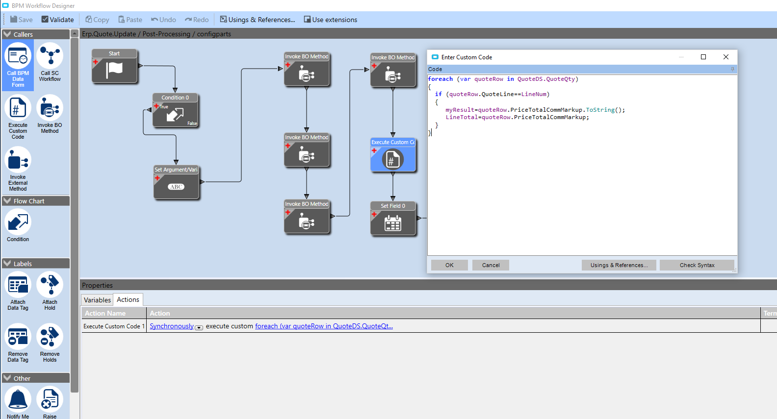

Not quite sure what I’m doing wrong. Would appreciate any and all guidance.
I run Erp.Quote.GetByID and put the data in the Quote tableset.
I can modify the tableset by executing custom code. I test this using some message boxes.
I then use the same tableset and submit it to Erp.Quote.Update. But the fields I’ve updated in step 2 aren’t updated in the database.
I know it all runs as I get the message box but that’s about it.
Any insights?QuoteDS.docx (123.5 KB)

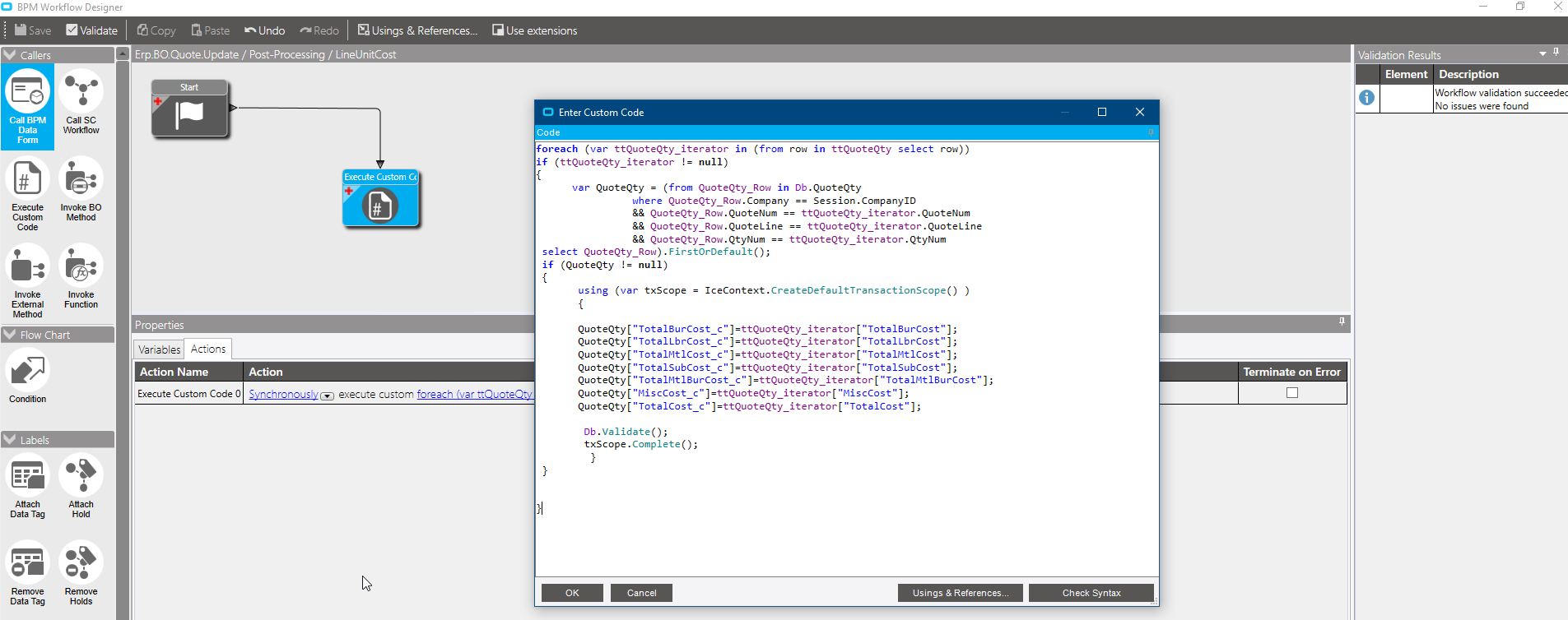

Here’s what I have in terms of code.
I created those 7 columns in the QuoteQty_UD table and added epiText boxes on the Quote worksheet, with EpiBinding to each of those UD columns. The post-processing process is enabled.
that should work for any quote line / Qty triggered to the ttTable, i.e. row mod status value changing, if you have a quote with multiple lines just alter any quantity field in each line and check
It’s working now! Now I’ve got to figure out how to use DMT to update them all.
