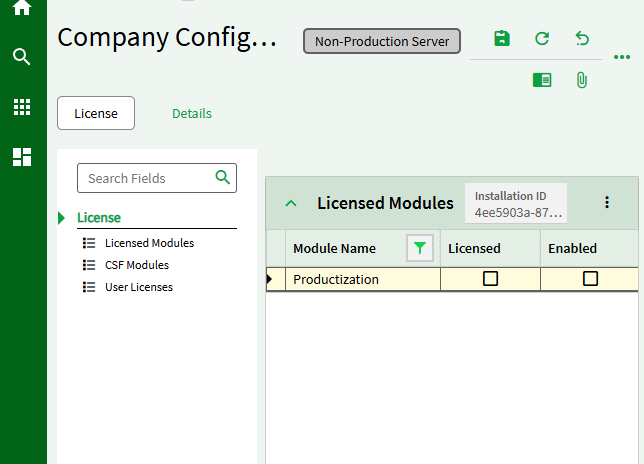

Productization module
Does anyone know what this is?
Seems it may enable Javascript Runner event action.

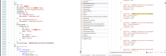

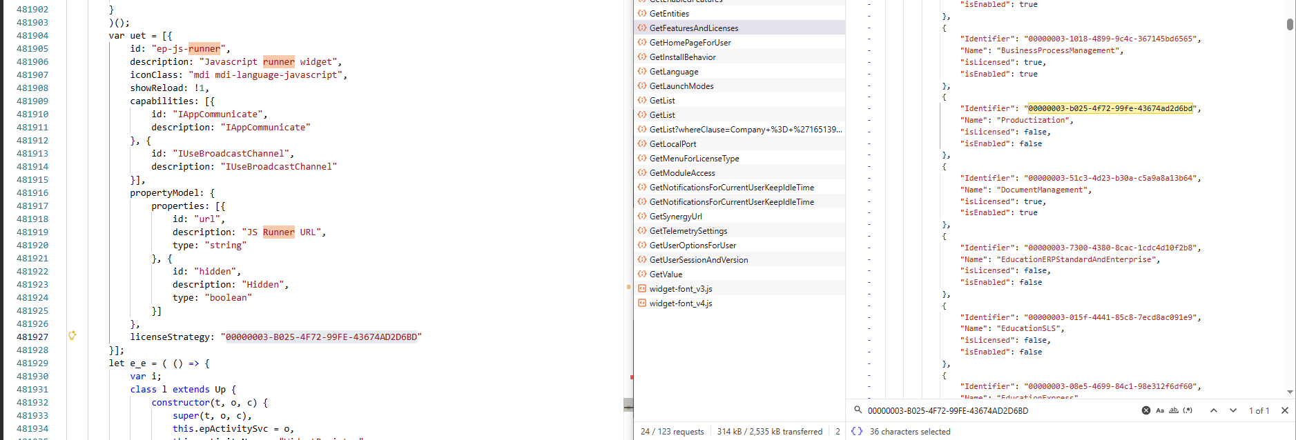

maybe its an obsolete license now but does appear that they used it’s guid to hide the JSRunner action

Nice find. I have just had a look, and I can see that ‘ep-embedded-app’ / ‘Javascript runner widget’. It’s not what I was thinking of that we used previously (a JavaScript event node). We don’t currently use it. From what I can see, I think it is more embedding applications rather than running JavaScript within the main form.

What I am interested in, is the js runner widget, which is very much misnamed.
(No… it’s not a javascript widget lol)
What it actually is, is an embedded app widget (iframe) with built in epicor plumbing for bidirectional comms, and even publish and subscribe.
I am VERY much interested in this, and how to purchase it. The design time is locked behind that license, but it’s obviously not even finished for that piece (design time) anyway after looking at the code lol. The json portion does work though.
