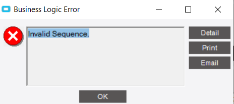

Can you really assign the line number to the PO?
@utaylor , If we are not passing the PO line then system is throwing error “PO Lines does not allow nulls.”
Did you pass 0?
Or did you pass nothing?
Try making that row with GetNewPODetail.
I have done the below mentioned changes now it’s working fine.

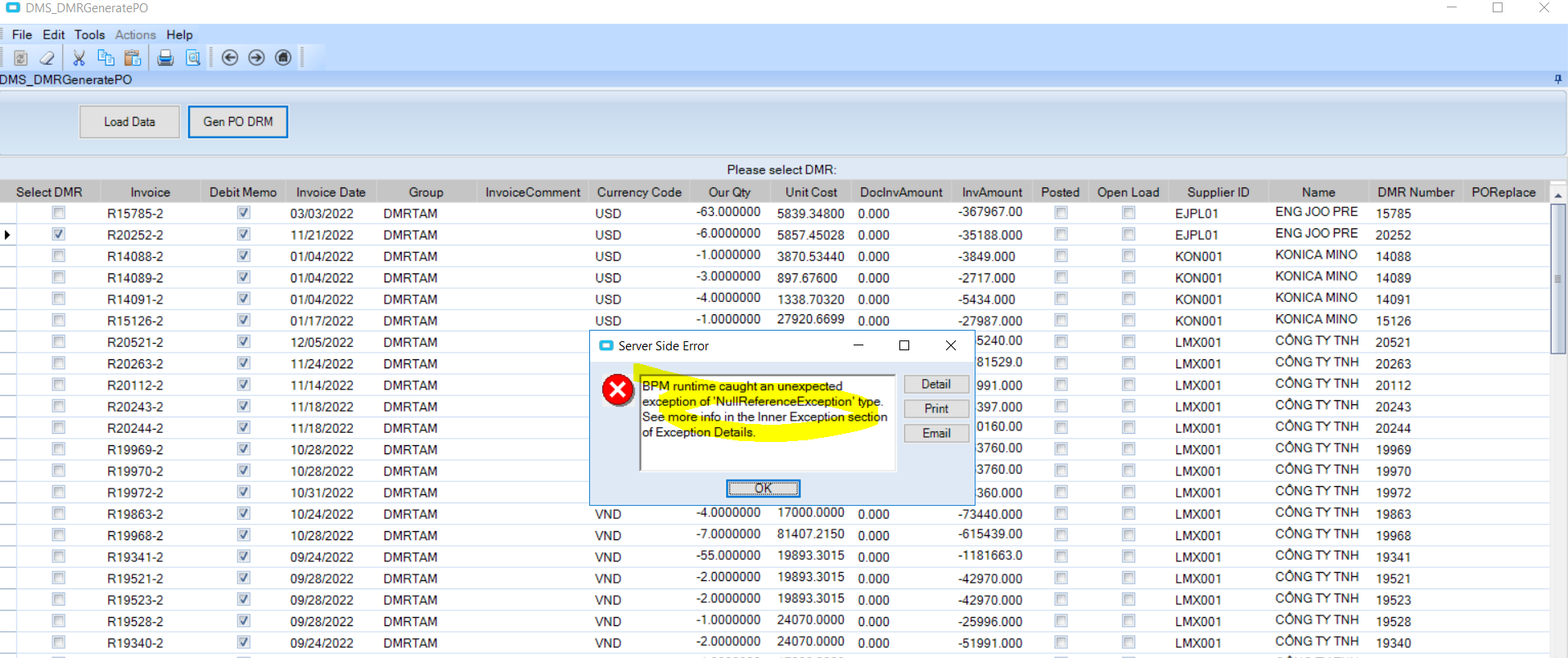

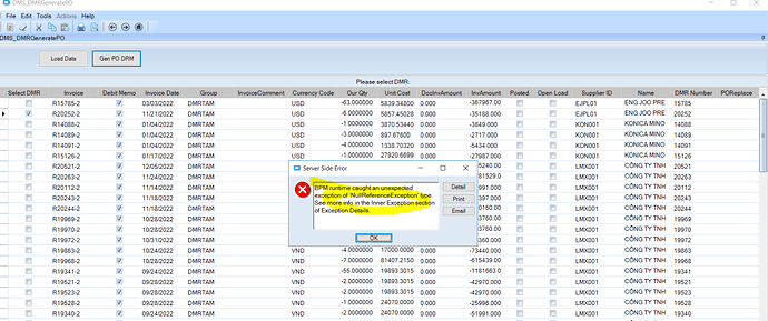

I also follow you but this error turns like it can’t generate POrel:
Server Side Exception
BPM runtime caught an unexpected exception of ‘NullReferenceException’ type.
See more info in the Inner Exception section of Exception Details.
Error Detail
Description: BPM runtime caught an unexpected exception of ‘NullReferenceException’ type.
Program: ERP.PORel.Triggers.dll
Method: A001_CustomCodeAction
Original Exception Type: NullReferenceException
Client Stack Trace
at Epicor.ServiceModel.Channels.ImplBase`1.ShouldRethrowNonRetryableException(Exception ex, DataSet dataSets)
at Erp.Proxy.BO.POImpl.Update(PODataSet ds)
at Erp.Adapters.POAdapter.OnUpdate()
at Ice.Lib.Framework.EpiBaseAdapter.Update()
at Script.CallPOAdapterGetNewPOHeaderMethod(Int32 DMRNum, Int32 VendorNum, String VendorID, String BuyerID, String PartNum, Decimal DMRHead_TotRejectedQty, Decimal UnitPrice)
Inner Exception
Object reference not set to an instance of an object.
here is my code:

            decimal DMRHead_TotRejectedQty=0, UnitPrice = 0;
			//adapterPO.GetByID(PONumNew);
			foreach (DataRow dtPOLine in tblVenNumPOGen.Rows)
				DMRNum = Int32.Parse(dtPOLine["DMRHead_DMRNum"].ToString());
				PartNum = dtPOLine["DMRHead_PartNum"].ToString();
				DMRHead_TotRejectedQty = Convert.ToDecimal(dtPOLine["DMRHead_TotRejectedQty"].ToString());
				UnitPrice = Convert.ToDecimal(dtPOLine["APInvDtl_UnitCost"].ToString());
				if (adapterPO.GetNewPODetail(PONumNew))
					adapterPO.POData.Tables["PODetail"].Rows[i]["POLine"]= Line;
					adapterPO.ChangeDetailPartNum(ref PartNum, Guid.Parse(adapterPO.POData.Tables["PODetail"].Rows[i]["SysRowID"].ToString()), "", a, out b);
					adapterPO.POData.Tables["PODetail"].Rows[i]["QtyOption"]   = "Our";
					adapterPO.POData.Tables["PODetail"].Rows[i]["DueDate"]   = DateTime.Now.Date;
					//adapterPO.POData.Tables["PODetail"].Rows[i]["OrderQty"]    = DMRHead_TotRejectedQty;//Suppler Qty (VenQty)
					//adapterPO.POData.Tables["PODetail"].Rows[i]["XOrderQty"]   = DMRHead_TotRejectedQty;//Our Qty
					adapterPO.ChangeDetailTranType("PUR-STK");
					adapterPO.ChangeDetailCalcOurQty(DMRHead_TotRejectedQty);
					//adapterPO.ChangeDetailCalcVendQty(DMRHead_TotRejectedQty);
					if (UnitPrice ==0)
						adapterPO.POData.Tables["PODetail"].Rows[i]["CheckBox02"]  = true;//Gift
					//set lại giá sau Qty để không bị lấy giá mặc trong PriceList
					//nếu là tiền VND cần update lại không sẽ lấy giá về 0
					if (adapterPO.POData.Tables["POHeader"].Rows[0]["CurrencyCode"].ToString()=="VND")
						adapterPO.POData.Tables["PODetail"].Rows[i]["CurrencySwitch"]   = false;
					adapterPO.POData.Tables["PODetail"].Rows[i]["DocScrUnitCost"]   = UnitPrice;
					adapterPO.POData.Tables["PODetail"].Rows[i]["DocUnitCost"]  = UnitPrice;//cột này là cột lưu đúng theo giá nếu là ngoại tệ sẽ là cột này
					//adapterPO.POData.Tables["PODetail"].Rows[i]["DocExtCost"]  = UnitPrice;
					//adapterPO.POData.Tables["PODetail"].Rows[i]["UnitCost"]  = UnitPrice;//cột này hệ thống sẽ tự quy đổi về tiền theo quốc gia của hệ thống ở VN là VND
					adapterPO.ChangeUnitPriceConfirmOverride(out sConfirmMsg);
					//adapterPO.ChangeUnitPrice();
					adapterPO.POData.Tables["PODetail"].Rows[i]["RowMod"] = "A";
					adapterPO.Update();
					adapterPO.POData.Tables["PORel"].Rows[i]["Number02"] = DMRNum;
					adapterPO.POData.Tables["PORel"].Rows[i]["Date01"] = adapterPO.POData.Tables["PODetail"].Rows[i]["DueDate"] ;//Delivery Date
					adapterPO.Update();
				i++;
				Line++;
			if (POLimit==1)
				adapterPO.POData.Tables["POHeader"].Rows[0]["Approve"] = true;
				adapterPO.POData.Tables["POHeader"].Rows[0]["ApprovalStatus"] = "A";
			else
				adapterPO.POData.Tables["POHeader"].Rows[0]["ApprovalStatus"] = "P";
			adapterPO.Update();
			// Cleanup Adapter Reference
			adapterPO.Dispose();
		} catch (System.Exception ex)
			ExceptionBox.Show(ex);
