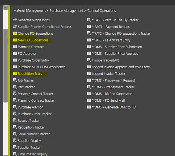

Why can't create New PO Suggestions via Erp.Adapters.POSugg.dll and Erp.Contracts.BO.POSugg.dll
I want to create New PO Suggestions (SugPoDtl) for Requisition
For example, 1 Requisitions has 5 Lines that have been Generate Suggestions and have 3 lines of PO that have been generated PO Sugges and have created POs as part of Requisition

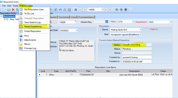

but due to mistakenly deleting PO Suggestions in the Purchase Order Suggestion Entry screen
Cannot Reset Dispatching part of Requisition to generate PO Sugges

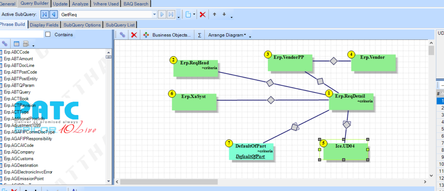

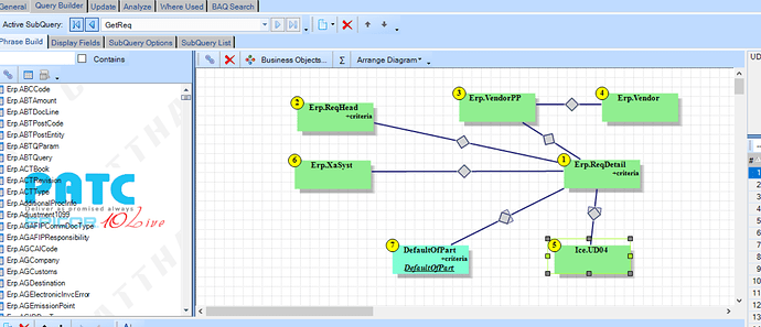

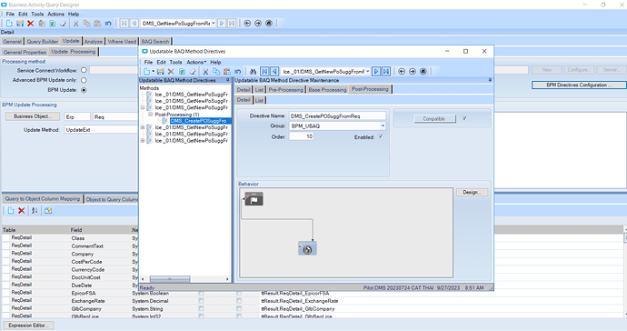

Temporarily, I use BAQ update’s BPM and use Erp.Tables; và Ice.Tablesets;
DMS_GetNewPoSuggFromReq.baq (86.1 KB)

with [DefaultOfPart] as
(select
	[PartPlant_Default].[Company] as [PartPlant_Default_Company],
	[PartPlant_Default].[Plant] as [PartPlant_Default_Plant],
	[PartPlant_Default].[PartNum] as [PartPlant_Default_PartNum],
	[PartPlant_Default].[PrimWhse] as [PartPlant_Default_PrimWhse],
	[PartPlant_Default].[LeadTime] as [PartPlant_Default_LeadTime],
	[PartPlant_Default].[BuyerID] as [PartPlant_Default_BuyerID],
	[PartPlant_Default].[PersonID] as [PartPlant_Default_PersonID],
	[PartPlant_Default].[CostMethod] as [PartPlant_Default_CostMethod],
	((case when PartPlant_Default.Plant=Constants.CurrentPlant then 0  else 1 end)) as [Calculated_CurrentPlant],
	(DENSE_RANK () OVER (PARTITION BY PartPlant_Default.Company, PartPlant_Default.PartNum order by PartPlant_Default.Company,CurrentPlant,PartPlant_Default.Plant )) as [Calculated_RankDese]
from Erp.PartPlant as PartPlant_Default)
select
	[ReqDetail].[Company] as [ReqDetail_Company],
	[ReqDetail].[OpenLine] as [ReqDetail_OpenLine],
	[ReqDetail].[ReqNum] as [ReqDetail_ReqNum],
	[ReqDetail].[ReqLine] as [ReqDetail_ReqLine],
	[ReqDetail].[LineDesc] as [ReqDetail_LineDesc],
	[ReqDetail].[PartNum] as [ReqDetail_PartNum],
	[ReqHead].[Company] as [ReqHead_Company],
	[ReqHead].[ReqNum] as [ReqHead_ReqNum],
	[ReqDetail].[IUM] as [ReqDetail_IUM],
	[ReqDetail].[UnitCost] as [ReqDetail_UnitCost],
	[ReqDetail].[DocUnitCost] as [ReqDetail_DocUnitCost],
	[ReqDetail].[Taxable] as [ReqDetail_Taxable],
	[ReqDetail].[RUM] as [ReqDetail_RUM],
	[ReqDetail].[CostPerCode] as [ReqDetail_CostPerCode],
	[ReqDetail].[VenPartNum] as [ReqDetail_VenPartNum],
	[ReqDetail].[CommentText] as [ReqDetail_CommentText],
	[ReqDetail].[Class] as [ReqDetail_Class],
	[ReqDetail].[RevisionNum] as [ReqDetail_RevisionNum],
	[ReqDetail].[RcvInspectionReq] as [ReqDetail_RcvInspectionReq],
	[ReqDetail].[VendorNum] as [ReqDetail_VendorNum],
	[ReqDetail].[PurPoint] as [ReqDetail_PurPoint],
	[ReqDetail].[PurchasingFactor] as [ReqDetail_PurchasingFactor],
	[ReqDetail].[DueDate] as [ReqDetail_DueDate],
	[ReqDetail].[PONUM] as [ReqDetail_PONUM],
	[ReqDetail].[POLine] as [ReqDetail_POLine],
	[ReqDetail].[PORelNum] as [ReqDetail_PORelNum],
	[ReqDetail].[JobNum] as [ReqDetail_JobNum],
	[ReqDetail].[PrcConNum] as [ReqDetail_PrcConNum],
	[ReqDetail].[CurrencyCode] as [ReqDetail_CurrencyCode],
	[ReqDetail].[ExchangeRate] as [ReqDetail_ExchangeRate],
	[ReqDetail].[LockRate] as [ReqDetail_LockRate],
	[ReqDetail].[ReqDate] as [ReqDetail_ReqDate],
	[ReqDetail].[OrderQty] as [ReqDetail_OrderQty],
	[ReqDetail].[XOrderQty] as [ReqDetail_XOrderQty],
	[ReqDetail].[JobSeqType] as [ReqDetail_JobSeqType],
	[ReqDetail].[TranType] as [ReqDetail_TranType],
	[ReqDetail].[GlbCompany] as [ReqDetail_GlbCompany],
	[ReqDetail].[GlbReqNum] as [ReqDetail_GlbReqNum],
	[ReqDetail].[GlbReqLine] as [ReqDetail_GlbReqLine],
	[ReqDetail].[PurchasingFactorDirection] as [ReqDetail_PurchasingFactorDirection],
	[ReqDetail].[Rpt1UnitCost] as [ReqDetail_Rpt1UnitCost],
	[ReqDetail].[Rpt2UnitCost] as [ReqDetail_Rpt2UnitCost],
	[ReqDetail].[Rpt3UnitCost] as [ReqDetail_Rpt3UnitCost],
	[ReqDetail].[RateGrpCode] as [ReqDetail_RateGrpCode],
	[ReqDetail].[MfgNum] as [ReqDetail_MfgNum],
	[ReqDetail].[MfgPartNum] as [ReqDetail_MfgPartNum],
	[ReqDetail].[SysRevID] as [ReqDetail_SysRevID],
	[ReqDetail].[SysRowID] as [ReqDetail_SysRowID],
	[ReqDetail].[OverridePriceList] as [ReqDetail_OverridePriceList],
	[ReqDetail].[EpicorFSA] as [ReqDetail_EpicorFSA],
	[ReqDetail].[Date09] as [ReqDetail_Date09],
	[ReqDetail].[CheckBox06] as [ReqDetail_CheckBox06],
	[ReqDetail].[ShortChar10] as [ReqDetail_ShortChar10],
	[ReqDetail].[ShortChar03] as [ReqDetail_ShortChar03],
	[ReqDetail].[CheckBox01] as [ReqDetail_CheckBox01],
	[ReqDetail].[Character10] as [ReqDetail_Character10],
	[Vendor].[VendorID] as [Vendor_VendorID],
	[Vendor].[TermsCode] as [Vendor_TermsCode],
	[Vendor].[DefaultFOB] as [Vendor_DefaultFOB],
	(isnull(DefaultOfPart.PartPlant_Default_Plant, Constants.CurrentPlant)) as [Calculated_Plant],
	(isnull(DefaultOfPart.PartPlant_Default_LeadTime, isnull(UD04.Number01,10))) as [Calculated_LeadTime],
	(isnull(DefaultOfPart.PartPlant_Default_PrimWhse,N'')) as [Calculated_PrimWhse],
	(isnull(DefaultOfPart.PartPlant_Default_BuyerID,N'')) as [Calculated_BuyerID],
	[XaSyst].[DefaultShipViaCode] as [XaSyst_DefaultShipViaCode],
	[Vendor].[Name] as [Vendor_Name]
from Erp.ReqDetail as ReqDetail
inner join Erp.ReqHead as ReqHead on
	ReqDetail.Company = ReqHead.Company
	and ReqDetail.ReqNum = ReqHead.ReqNum

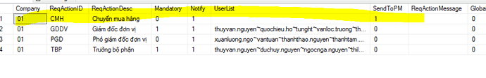

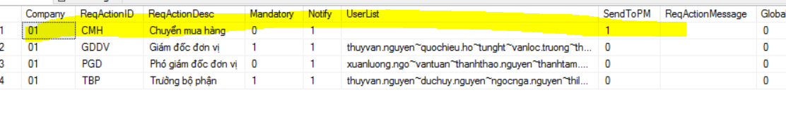

	and ( ReqHead.ReqActionID = 'CMH'  )
inner join Erp.VendorPP as VendorPP on
	ReqDetail.Company = VendorPP.Company
	and ReqDetail.VendorNum = VendorPP.VendorNum
	and ReqDetail.PurPoint = VendorPP.PurPoint
inner join Erp.Vendor as Vendor on
	VendorPP.Company = Vendor.Company
	and VendorPP.VendorNum = Vendor.VendorNum
left outer join Ice.UD04 as UD04 on
	UD04.Company = ReqDetail.Company
	and UD04.Key1 = ReqDetail.PartNum
inner join Erp.XaSyst as XaSyst on
	ReqDetail.Company = XaSyst.Company
left outer join  DefaultOfPart  as DefaultOfPart on
	ReqDetail.Company = DefaultOfPart.PartPlant_Default_Company
	and ReqDetail.PartNum = DefaultOfPart.PartPlant_Default_PartNum
	and ( DefaultOfPart.Calculated_RankDese = 1  )
where (ReqDetail.Company = @CurrentCompany  and ReqDetail.OpenLine = 1  and ReqDetail.ReqNum = @ReqNum  and ReqDetail.ReqLine = @ReqLine)
With this method, I have to get the exact information of each column of PO Suggestions to assign to it. I cannot use the built-in functions of Erp.Adapters.POSugg like other screens.
I researched and found a suggestion to create PO directly from the remaining 2 lines of Requisition but currently I still want to go through PO Suggestions
In BPM, I have not checked the ReqNum condition, ReqLine will not be created PO Suggestions
Thank you very much! Have a good day! :smiling_face_with_three_hearts: :smiling_face_with_three_hearts:

I tried running it again but it didn’t work. Just use Reset Dispatching Requisition and then run generate suggestions but it will have to Reset Dispatching the entire Requisition and management will have to review this. The company doesn’t want to.

I don’t know what Reset Dispatching is, but we totally clear and regen every weekend.
Reset Dispatching:
The request will be approved through level 2 and a proposal will be created.
select * from ReqActs where Company='01'
Currently, the company also automatically runs generate suggestions at 12 noon every day!
