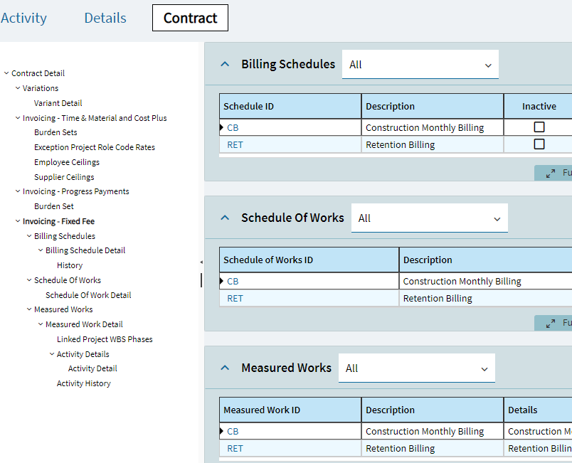

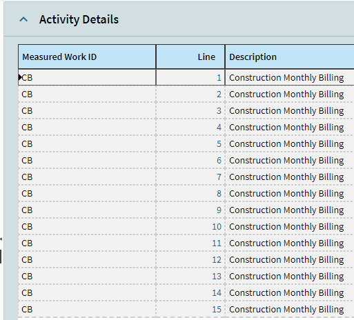

@cmd1 we are also an Engineer to order company and use the Project Billing module. A lot of our customers use pay apps and there isn’t a great solution to generate a payapp that correctly generates all the info expected on a pay app. So what we typically do is fill out the pay app in excel and send it to the customer. Then we create a fixed fee invoice through the project entry module with 1 line that matches the total of the payapp. B/c we never really send the epicor invoice to the customer, I only create 1 Billing Schedule, 1 schedule of work and 1 measured work and then generate a billing activity for each submission of the pay app, see screen shots below. You could certainly break it out into more detail, but we’ve found we don’t need that b/c it’s all captured in the payapp.
The project billing module offers multiple other ways to bill as well. Unfortunately they all require different processes and recognition procedures, which just adds bloat to your process (IMO). Doing it this way doesn’t require you to ship “jobs”. Unfortunately epicor also doesn’t really have any great project costing reporting (IMO), so we have a custom report that is used to monitor project costing.
If you do proceed with the project module, I would HIGHLY recommend that you add dymanic segments to your GL accounts and you capture your costs by project at the GL level.
Hopefully you find some of that useful. I’m happy to try and answer additional questions you have.
