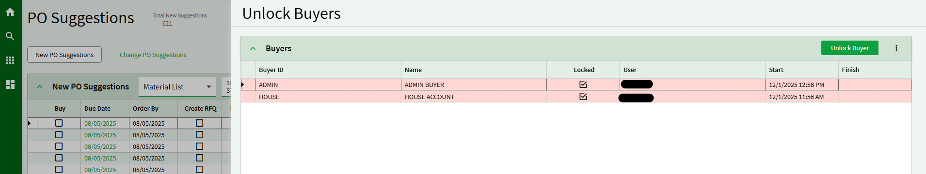

Apparently it’s not a dead task as I don’t see any sysTask record related to this. Exact error is upon Process Suggestions buttton (not generate suggs process)
Business Layer Exception
Buyer HOUSE is currently processing suggestions since 12/1/2025 11:56:55 AM for user username.
Error Detail
Correlation ID: 4cb3c367-9155-4acf-b4b1-6e5d77e330a5
Description: Buyer HOUSE is currently processing suggestions since 12/1/2025 11:56:55 AM for user username.
Program: Erp.Services.BO.POSugg.dll
Method: LockBuyerUpd
Table: undefined
Field: undefined

Thanks yeah I saw that. Didn’t compile but BAQ showed my prob is not a systask rather it’s a locked buyer.
Table PurAgent…look for fields prefixed ProcPOSugg

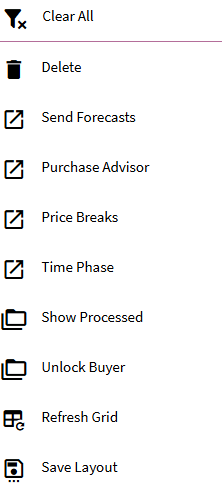

We seen this in our Pilot for 2025.2.7 there is a hotfix from Epicor to fix it.
looks like kinetic PO Suggestions has a built-in Unlock Buyer feature. who knew?
prob solved.
Fix available in EpicCare KB0142365
Nice…didn’t know it existed either but here we are. Good to know.
Thanks, I knew of the fix but not the KB to reference it
support tech learned something too. got notice from above after trying two datafixes…
Yes, it’s a nice upgrade to Kinetic PO Suggs.

So to clarify, conversion 790 fixed the underlying problem caused by 2025.2.7 which broke PO Entry & PO Suggs (Duplicate record error on save new PO). IF you ran Process Suggestions btn on PO Suggs in the meantime, you;d also have a locked buyer. Unlock Buyer action was the fix to that related issue. No datafix needed.
