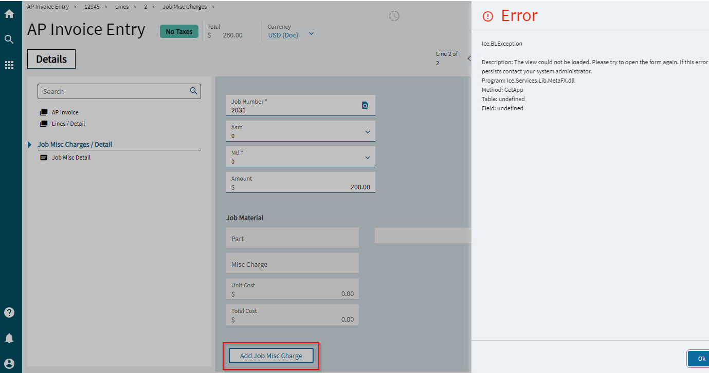

PSA: Adding Job Misc Charges on AP Invoices is broken ***BUSINESS STOPPED***
For those on 2024.1.10 (Cloud)
When attempting to add a job misc charge to an AP invoice:
Support is aware of the issue and it will be rolled up into .12, and they are providing a hotfix for now (but it did not work for us). Confirmed on their standard OOB learning environment as well.

Hey Friends!
We cannot pay AP Invoices via the Classic or Kinetic (client/browser). Please advise, we are dependent on this functionally, and it has stopped business.
What’s going on? The base education 2024.1.10 environment has the same web/kinetic error.

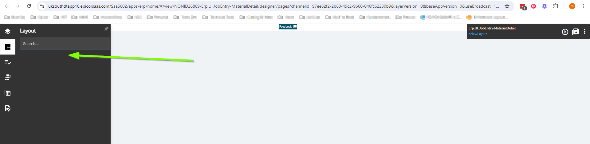

The base layer is empty:
I raised this with support on June 26th…! UK customers were much earlier to the 2024.1 party.
QA wise the fact that the layer is completely empty suggests that in fact DOES NOT get tested.

When I looked at an on-prem system the layout.json file is completely empty. Zero QA peformed on this for that to have been deployed to the masses in my view - and the time to fix has been far too long, especially considering if what I’ve seen is correct all they needed to do was restore that file from the previous build.
if someone can get the json from getapp from the previous version I can make a quick and dirty fix.
