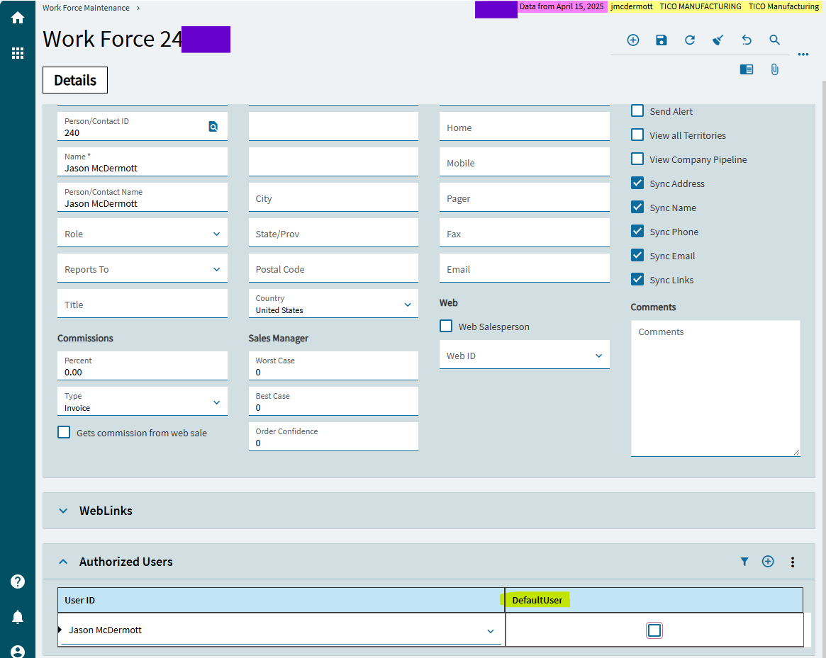

| Work Force | Authorized User List | DefaultUser | UserComp.PrimSalesRepID |
string |

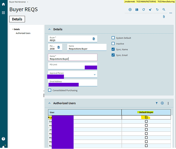

I was explaining to a coworker that the “default buyer” is what it says, but not at all what you assume from the screen.
When you look at this picture you think that Ca***** is the default user assigned to the REQS buyer ID.
In fact,
- There can be many users checked here on this buyer
- Conversely, each user (meaning each human, basically) can only have one buyer ID that is their default
a. In other words, Ca***** cannot be the default on another buyer ID.
This led me to explain that this “checkbox” is not a Boolean in the database at all - it triggers a write to a STRING field on the User table. (There are actually two user tables, and it’s UserComp in this case, not UserFile - FYI.)
