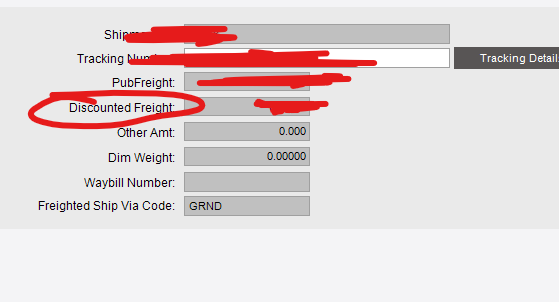

@jgiese.wci, were these charges being then returned to the “Discounted Freight” field?
Phil, are these the charges that return back to the “Discounted Freight” field in Epicor?
There was an additional bug with this. I had to upgrade QuickShip again to get it. It was sending the surgcharged charge and QuickShip wasn’t sending it to Epicor.
What version are you on now? And what version were you on with the additional bug?
