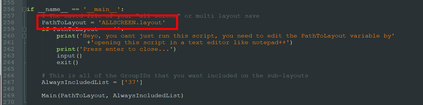

You should be able to use this without modifying much code. You’d only need to point it at the right .layout file.
I think the only dependencies are beautifulsoup and xml, but depending on where you get your install they my be built into your install.

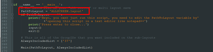

So if you did decide to use this script, you’d only need to change this variable from ALLSCREEN.layout to whatever your layout file is actually called.

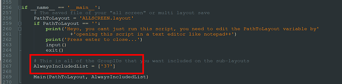

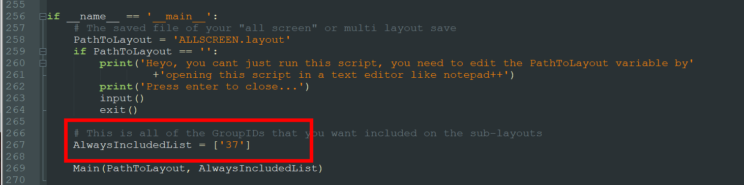

If you wanted to combine multiple tabs on your layout on a given output, you would use this AlwaysIncludedList variable, but it sounds like based on your situation that you would just leave this blank.
