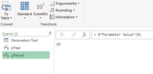

where doe this “value” come from?
mine looks like
/api/v1/BaqSvc/HDTA-Rebate/?FiscalPeriod=9&FiscalYear=2022", null, [Implementation=“2.0”])
I tried changing the =9 to =pPeriod
/api/v1/BaqSvc/HDTA-Rebate/?FiscalPeriod=pPeriod&FiscalYear=2022", null, [Implementation=“2.0”])
but this gives me the error above? My Parameter for pPeriod looks like the sample below that i feel is how it should look

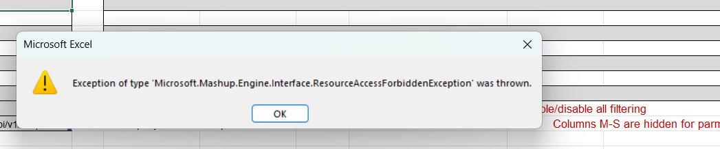

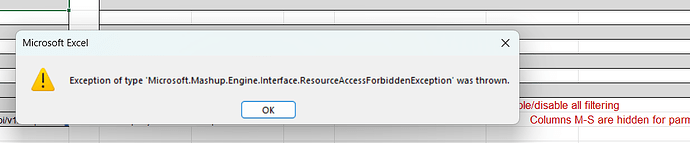

Followed this guide step-by-step but can’t seem to get past this error to actually retrieve the data. I believe everything is setup properly. We are on the cloud version of Kinetic.
Any ideas what this might be ?
From the error it appears you are using either an invalid login or API key without proper access to the BAQ or BO.
You should start a new topic for yourself and reference this one if it applies to your issue as this one was previously solved. :slight_smile:
