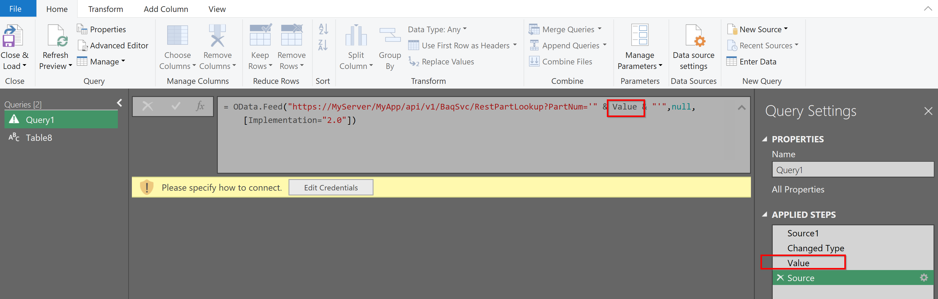

You can do this using Power Query with Excel. Depending on version of Excel how you access Power Query may vary. You can basically then pass parameters to your BAQ via REST using the columns in your spreadsheet. I can post a few examples of this tomorrow. Power Query is a free add-in for 2010 and 2013 and bundled with 2016 including O365.

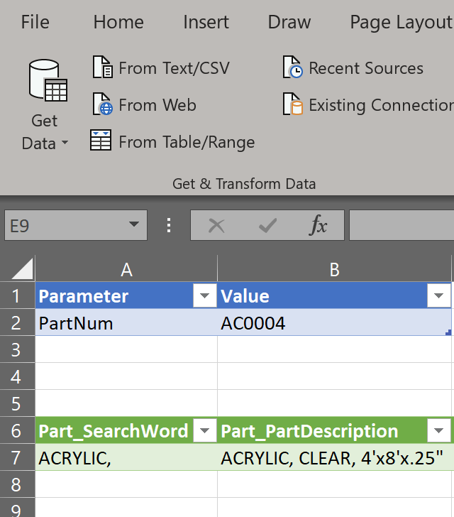

The example below has a table in rows 1 & 2 which contains a Parameter Name and Value
In Row 6 is a REST Query that uses the value in cell B2 (under value) to feed to a BAQ with a Parameter of PartNum. This then returns those values to the sheet. You can simply change the value again and click refresh to retrieve different part data. Now you could have a list of Part Numbers under value instead of just one and use some query merge functionality to provide what you are looking for.

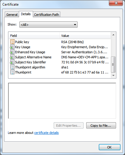

You can create a self-signed then go visit the API Help or something via Chrome.
You can then click on the Not Secure Area on the URL Bar (the red) and Click on Certificate… then it brings up a Dialog you can Export it to a File
Then on Win7 atleast If I recall you go to Internet Options and you can there import that Cert in the Trusted Root Tab, when it comes to mass scale you can prob use GPO to push that out to your local users, i am sure there is a powershell or something out there.
2019-05-22_1044
Thats how you can get it working internally, locally and Excel will be happy. Atleast on your dev machine.

Hey @danbedwards, did you ever get around to making that example? I downloaded power query for 2013 and I can get the fill list, but I can’t seem to figure out how you do what you are showing in your screen shot.
Dan, Did you end up creating an example of this. Im having difficulty using a parameter to update the query in power query and would appreciate any help you might be able to provide
