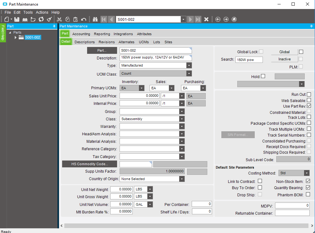

This is how the part maintenance looks like:

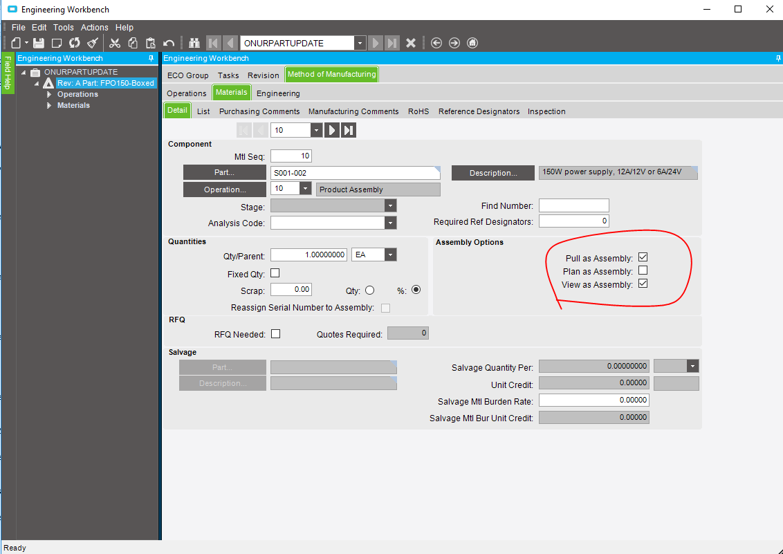

This is what the Method looks like:
The Non-Stock flag is tricky to explain. Read the help for that field.
If a mfg’d part is ‘Non-Stock’, it means that you prefer not to stock it, that you’ll make it as needed. But it can be stocked. You probably want this cleared.

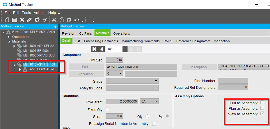

Also of importance in the BOM for top level is whether the two subs assemblies are marked as Pull as Assembly, or not.
And the answer to your first question is, yes. We have a subassembly that we stock and make separate jobs to fulfill stock. And the final assy only ever pulls the sub-assy from stock.

So I looked at the BOM top level and seen that the SubAssemblies are set as Pull as Subassembly and View as SubAssembly. Here is how it looks:
I also read application help explanation of what these mean but that kinda confused me further. What I understood was that our current setup, Pull As Assembly, means manufacture the subassembly without checking stock. Is that correct?
Would I also need to check this box in Part Maintenance for the subassembly?
P.S: We got great savings on power supplies, 150 Watt for the price of 144 Watt :slight_smile:
So I’ve tried our regular process but this time with Pull as assembly unchecked but it still issued raw materials from Mass Issue to mfg.

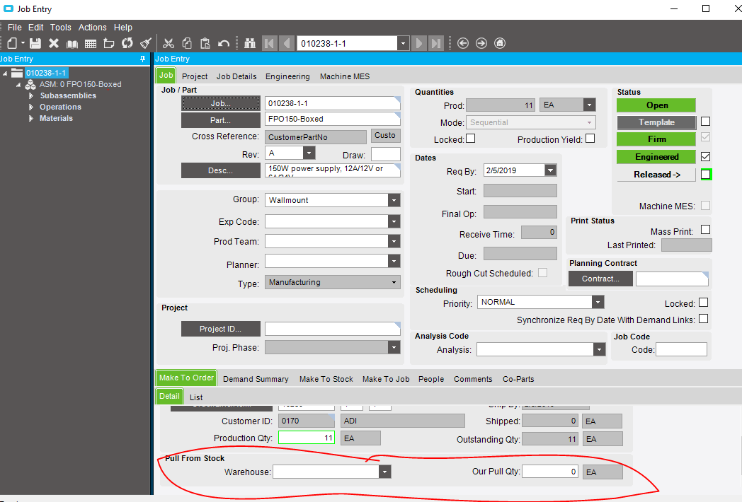

Would someone need to use pull from stock so that it gets pulled from stock? Is there a way that requires no human touch?(Employees here get discouraged if things require reading and clicking things :man_facepalming:):
That circled part in the second pict has to do with satisfying demand for the finished part.

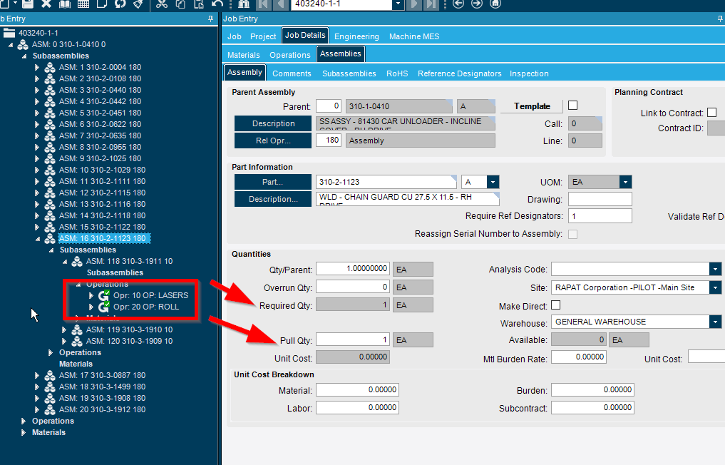

In the example screen shot below, I set one of the assemblies to have a pull quantity of 1 which equals the total quantity required. If I then look in the assembly below, you see that the operation show green check marks, not because anyone did anything, but because the quantity required is now 0.
If you look at the screen shot you can see the required quantity below is now 0 because an assembly above is is going to satisfy the requirement and these are no longer needed.
You can’t change the production quantity directly. That is derived from the demand links, BOM, and pull quantity settings. So you don’t need to change anything.
We don’t use mass issue, we backflush, but I would assume that the mass issue should look at required quantity and see that it’s 0 so it shouldn’t issue the materials below it. (but do some testing before you take that as gospel)
