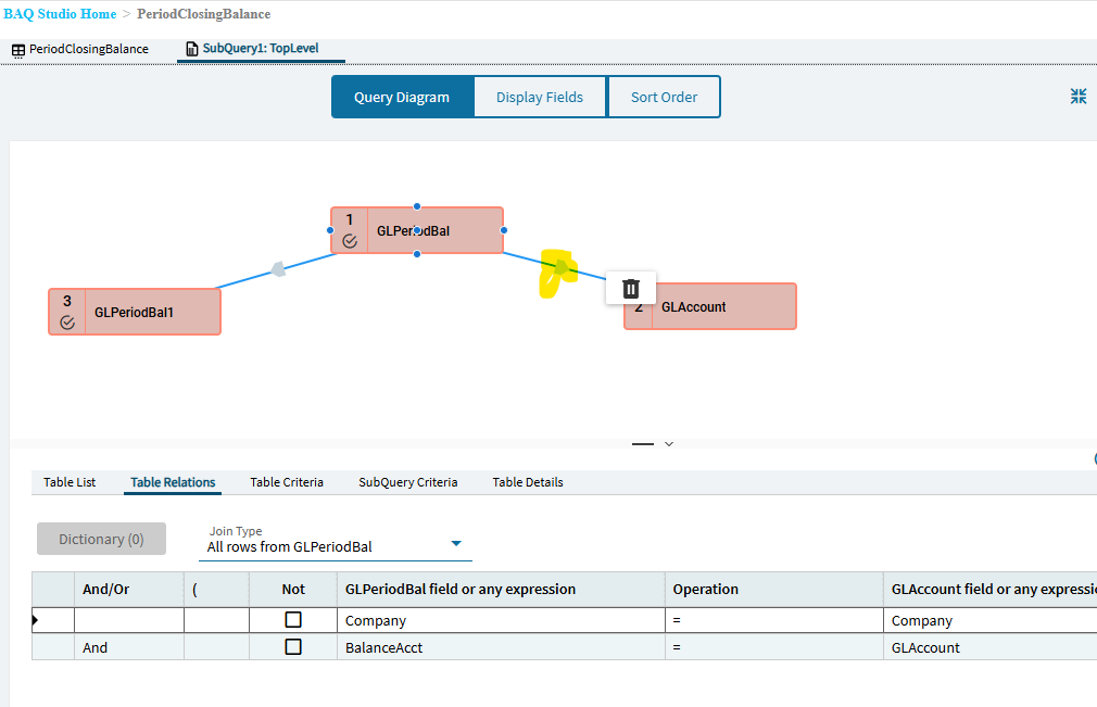

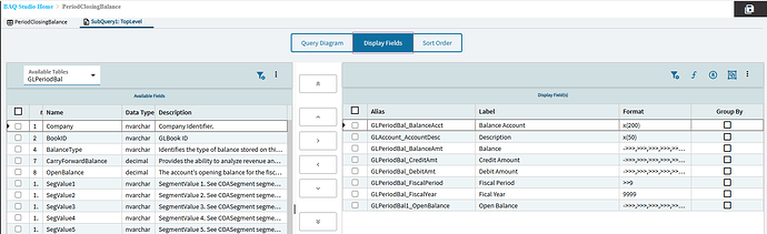

select
	[GLPeriodBal].[BalanceAcct] as [GLPeriodBal_BalanceAcct],
	[GLAccount].[AccountDesc] as [GLAccount_AccountDesc],
	[GLPeriodBal].[BalanceAmt] as [GLPeriodBal_BalanceAmt],
	[GLPeriodBal].[CreditAmt] as [GLPeriodBal_CreditAmt],
	[GLPeriodBal].[DebitAmt] as [GLPeriodBal_DebitAmt],
	[GLPeriodBal].[FiscalPeriod] as [GLPeriodBal_FiscalPeriod],
	[GLPeriodBal].[FiscalYear] as [GLPeriodBal_FiscalYear],
	[GLPeriodBal1].[OpenBalance] as [GLPeriodBal1_OpenBalance]
from Erp.GLPeriodBal as [GLPeriodBal]
left outer join Erp.GLAccount as [GLAccount] on
	  GLPeriodBal.Company = GLAccount.Company
	and  GLPeriodBal.BalanceAcct = GLAccount.GLAccount

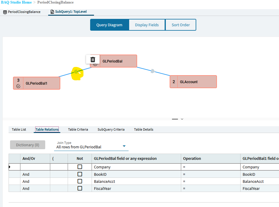

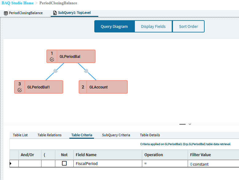

left outer join Erp.GLPeriodBal as [GLPeriodBal1] on
	  GLPeriodBal.Company = GLPeriodBal1.Company
	and  GLPeriodBal.BookID = GLPeriodBal1.BookID
	and  GLPeriodBal.BalanceAcct = GLPeriodBal1.BalanceAcct
	and  GLPeriodBal.FiscalYear = GLPeriodBal1.FiscalYear
	and ( GLPeriodBal1.FiscalPeriod = 0  )

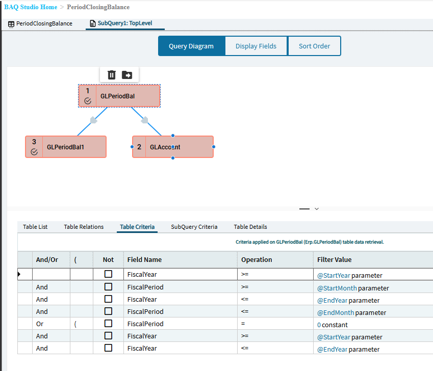

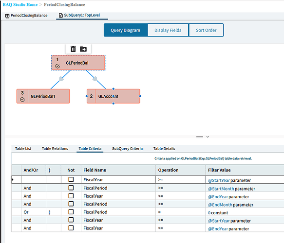

where (GLPeriodBal.FiscalYear >= @StartYear
and GLPeriodBal.FiscalPeriod >= @StartMonth
and GLPeriodBal.FiscalYear <= @EndYear
and GLPeriodBal.FiscalPeriod <= @EndMonth
or (GLPeriodBal.FiscalPeriod = 0
and GLPeriodBal.FiscalYear >= @StartYear
and GLPeriodBal.FiscalYear <= @EndYear ))
