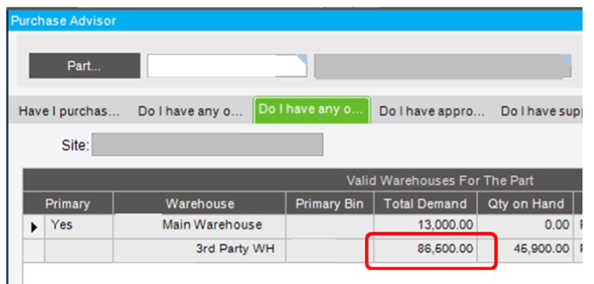

We have encountered a Total Demand number (for the 3rd party WH) that does not match what we think is the total demand for that warehouse (or at all). A BAQ on PartWhse for the part reveals that the value is the value of SalesDemandQty. What we cannot figure out is how this value is calculated.
Purchase Advisor shows:
• Main warehouse: 13,000
• 3rd party WH; 86,500

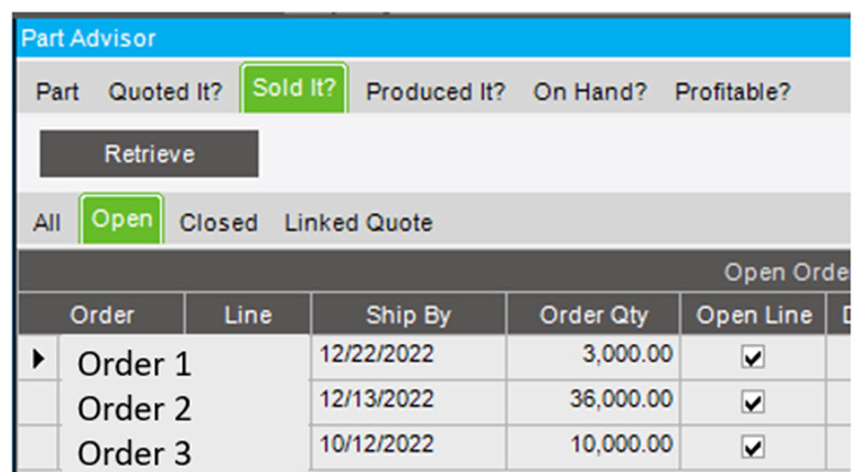

The Main warehouse demand matches Order 1 and Order 3, which will be drop shipped.
Order 2, which will be shipped from 3rd party WH, is for 36,000.

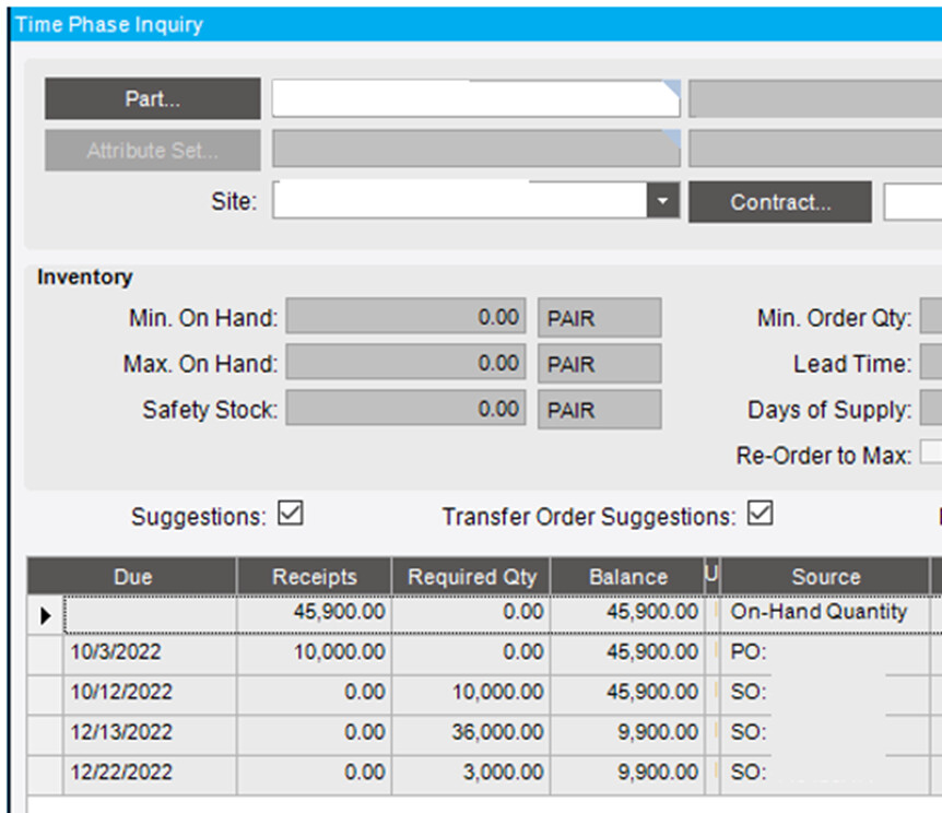

Time phase shows no other activity (but includes the drop ship PO for Order 3)
There is no forecast or job-related demand for this part. How is the demand number calculated?

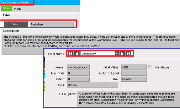

I believe the demand qty comes from the PartWhse, a summary table which can get out of whack?

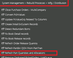

Have you tried any of the Refresh processes?
(E10.1.6 shown… menu location may vary with versions)
Thanks. Will try after close of business. This would be a wonderful solution!
That did it! Thanks so much
