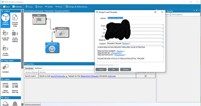

I want to set up an email notification for Purchase requisition when it gets approved by HOD. I do have Data Directive(ReqHead) already set up for “Requiring attention for review” and it goes to HOD but once HOD approves I want to get email notification as well. I would like to use nested loop(1 or more condition) to have everything under one table. Attached snapshot is the bpm already set up for review required.
Any help will be appreciated.

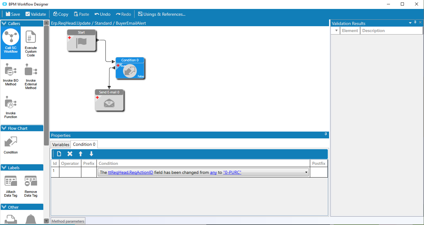

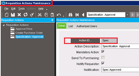

Wonder if as simple as making a copy of the existing BPM
only… a different ReqActionID in the condition?
e.g. on my Test system, Supervisro Approval Action ID happens to be “Spec”
Perfect! It worked that way.
Thank you Man!

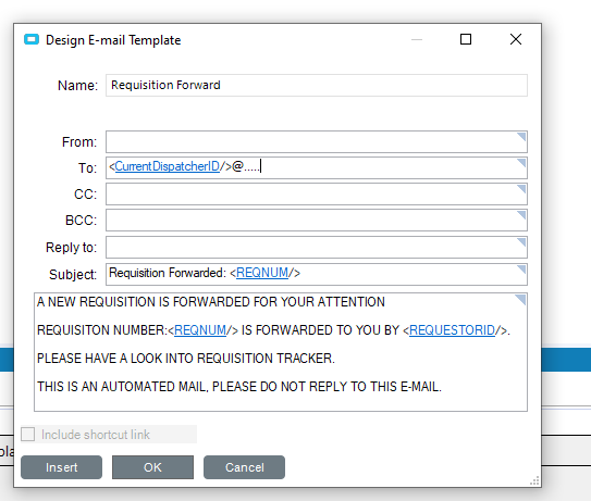

Hi - How did you set the “To” email? I need to do something similar and I got the email to work and send to a specific email address, however I need to send to the applicable Dispatcher ID.
Hi Debbie, You should set it to “CurrentDispatcherID”@yourdomainname. and it should work.

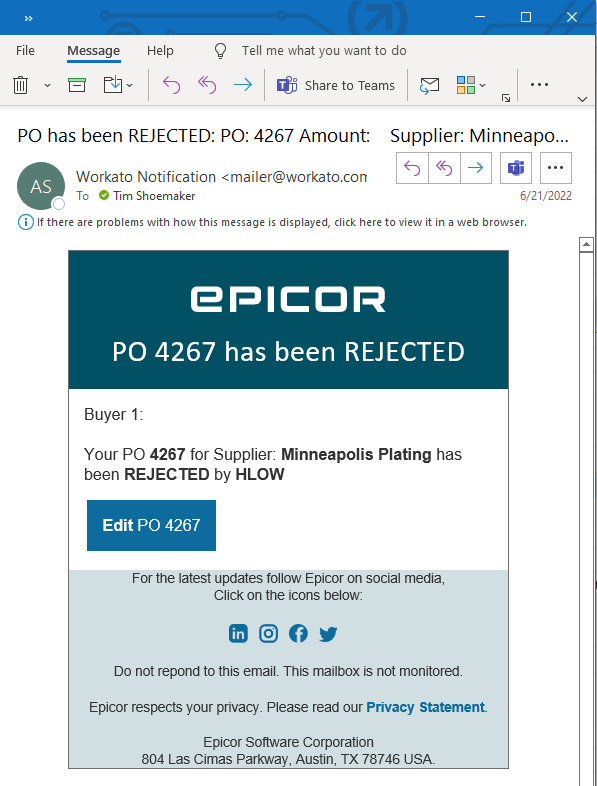

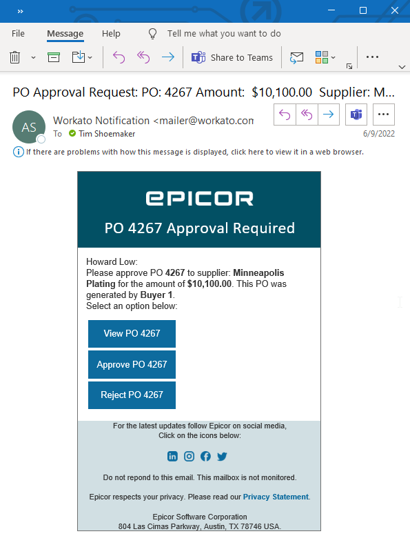

Have you all seen the PO Approval email that we generated as a demonstration for #AutomationStudio? This same thing could be created for PO Requisition approval.
This automation does the following:
  1. builds and sends a nicely formatted email to the approver. This email has three buttons: 1. VIEW the PO (could be changed to View the Requisition), 2. Approve, 3. Reject.
  2. When the approver receives the email, if they press the view button, it takes them directly to the screen to see the content. This even works from a phone that has internet access. If they press Approve/Reject, it sends a message back to Automation Studio to execute the action.
  3. When an action is received, it sends an email to the requestor stating the status change. It also executes the action, either approving or rejecting the PO (could be changed to PO Req).
Screenshot of initial Email. Note you can easily change the logo at top and the color scheme of this email. We designed it to be easily customizable. It can also be sent via Outlook, or Gmail.
Here is a screenshot of the REJECTION (accept email is very similar);
This solution requires NO C# code, NO BPMs… 100% completed in Automation Studio with a low code solution (it does require a little HTML formatting code to make things bold in the email.)

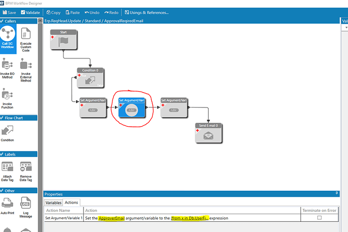

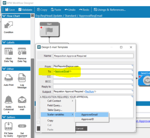

I am not familiar with Automation Studio but assume it is an add-on. I did figure out how to get my email address from the UserFile Table.

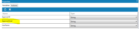

  1. Created a string Variable in my BPM for ApproverEmail

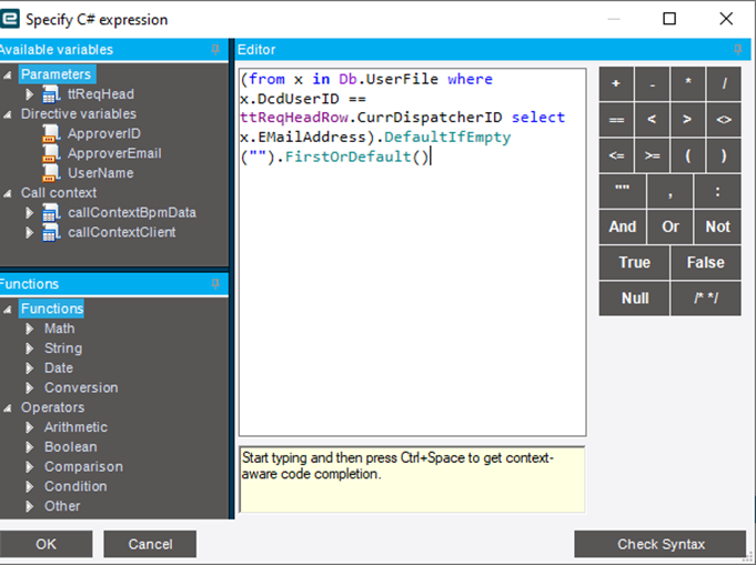

  2. Used “Set Argument/Variable” using the following expression:
    (from x in Db.UserFile where x.DcdUserID == ttReqHeadRow.CurrDispatcherID select x.EMailAddress).DefaultIfEmpty("").FirstOrDefault()
  3. On the To: section of the “Send E-mail” in the BPM, I used “Insert > Scalar Variables” and selected the ApproverEmail variable.

Hi @dgross can show me where to put
  1. Used “Set Argument/Variable” using the following expression:
    (from x in Db.UserFile where x.DcdUserID == ttReqHeadRow.CurrDispatcherID select x.EMailAddress).DefaultIfEmpty(“”).FirstOrDefault()
I tried to set the argument but cannot

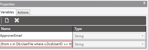

Here is how I set the ApproverEmail Variable:
Editor value: (from x in Db.UserFile where x.DcdUserID == ttReqHeadRow.CurrDispatcherID select x.EMailAddress).DefaultIfEmpty(“”).FirstOrDefault()
Thank you very much @dgross !
