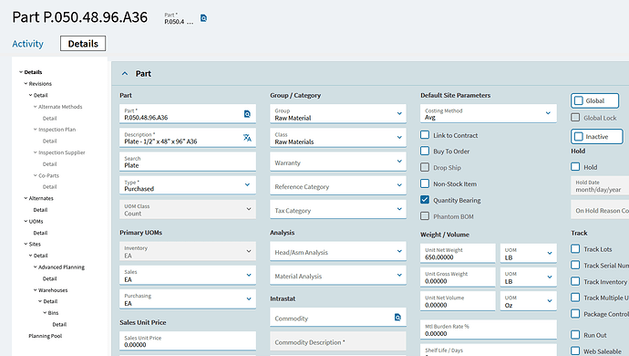

Todays dumb question - where do I enter a vendor cost for a purchased part lol?? I cannot find it anywhere… I am missing something stupid. Only place that I can enter a number is “sales unit price” but that cannot be a cost…or is it? I am not looking for anything other than where do I put my cost to purchase this item from a vendor. Thanks.

There are lots of costing methods you can use to determine the parts cost. The part in your screenshot is set to Average Cost costing method. In short, Epicor will use a weighted average of the cost of the part for each receipt to determine the cost. If you want to straight up enter in a cost for a part, you need to change the costing method to ‘Sandard’. Even that isn’t as simple as entering in a number for cost. Epicor uses separate values for Material, Labor, and Burden to make up the total ‘cost’ for a part. I am way oversimplifying all of this but you are opening a can of worms.
