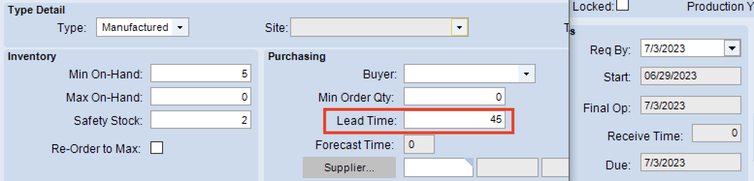

I stumbled across an old part in our system that was marked as Manufactured, Process MRP, and the Purchasing Lead Time set to 45. The warehouse inventory settings had not been cleared so MRP was creating a job to get inventory above the ROP. We did not have any other demand in the system so the Job suggestion was just for stock.

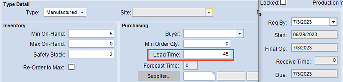

The interesting thing I found, was that MRP would forward-schedule starting 45 production calendar days in the future. I changed the lead to 90 and ran it again in our Test Environments(10.2.600.9 and 2022.2.10) and confirmed that MRP will forward-schedule starting 90 production calendar days in the future. And then testing again by clearing the Lead Time and running MRP again, the Job was scheduled to start immediately just like other stock-only suggestions.
If firm demand, such as a Sales Order is created, MRP will plan for that due date and ignore the lead time number.
I’m curious if anyone has seen the same functionality and if anyone is utilizing or would utilize this or is this just a bug in MRP? I could not find any MRP documentation that a Manufactured part would use this field in the MRP planning process.

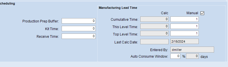

Try entering a Manufacturing Lead Time on the part and see what happens.

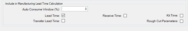

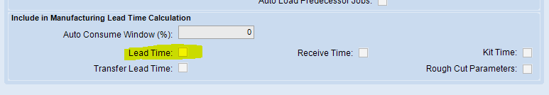

There is a setting to include purchasing lead time in the manufacturing lead time calculation in Site Maintenance → Planning

Unfortunately that didn’t work, U job created 7/4/2024, expecting today…
Will try setting Mfg Lead time to 1 day … stay tuned…
Back to square 1, U job still way out there ( 7/4/2024)
That setting is for calculating the Mfg Lead Time. That determines what the system considers when you run the Calculation Process.
I was referencing the Manual Mfg Lead Time you can enter on the Part. I would include screen shots, but that is not in 8.
Is this what you were referencing ?
Yes! Now when you run MRP, what is the lead time on your part?
Still 7/4/2024

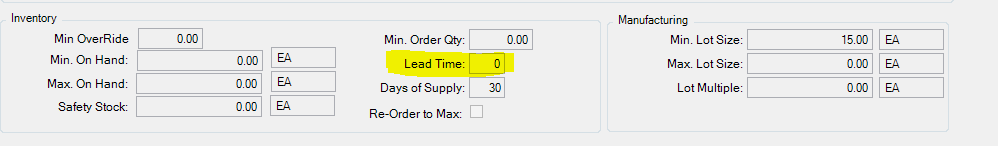

When I changed Mfg Cumulative time to 42 and Purchasing lead time to 0 , Ujob created now
