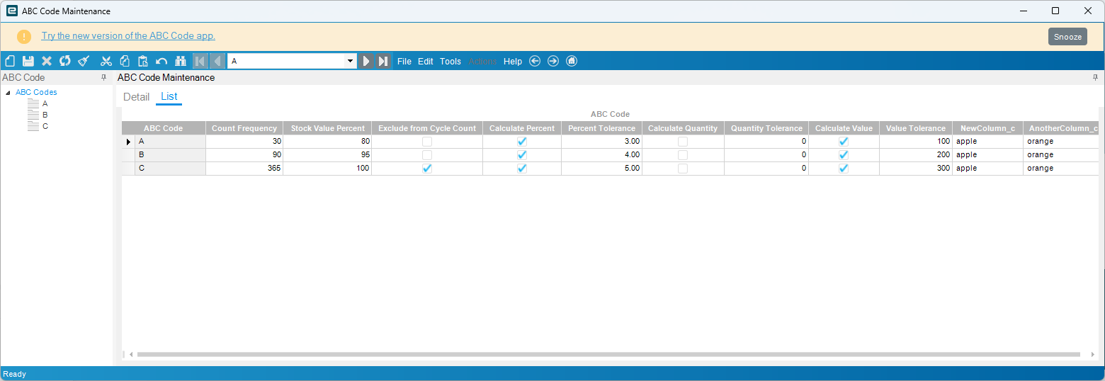

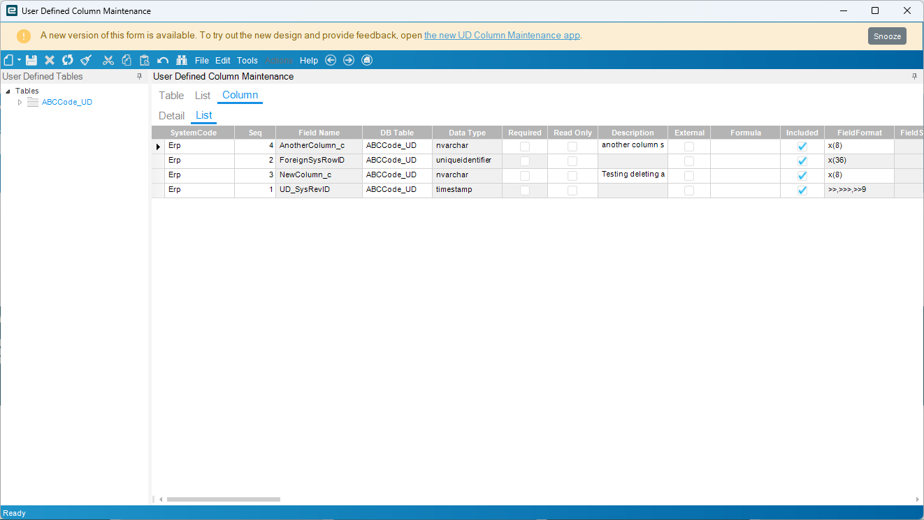

added a field with a default value
added another field because you can’t delete the last UD column (you get an error message)

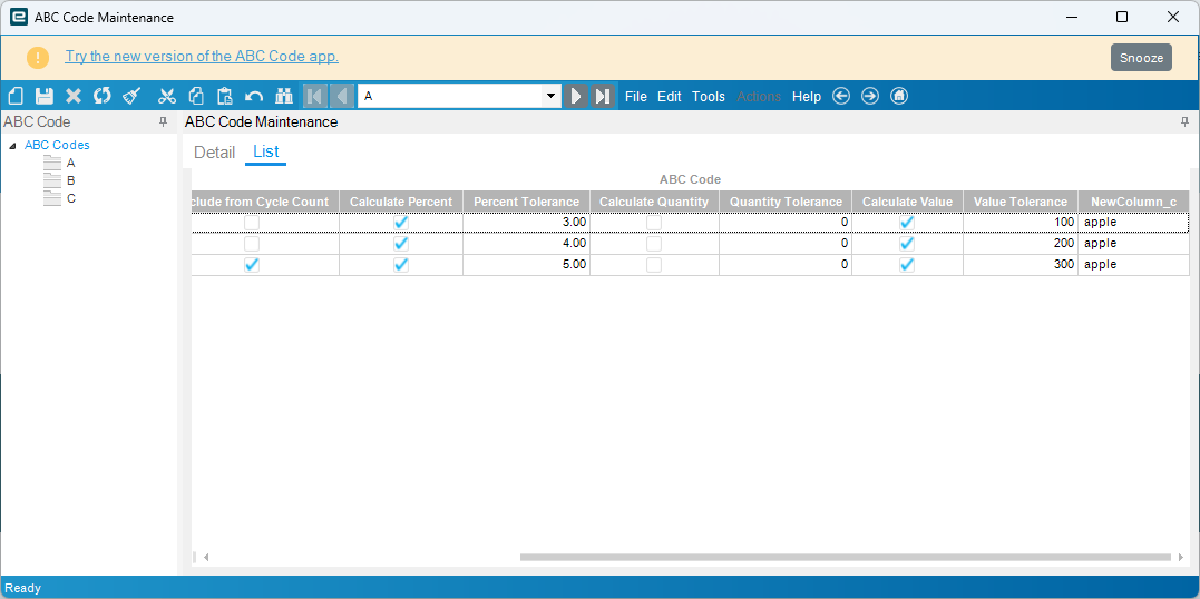

Deleted the column, Then added it back
I actually closed the UD screen down and added the field back using paste insert, but the copy data had no SysrowID or Sysrevid in it.
Hope that helps your friend.
