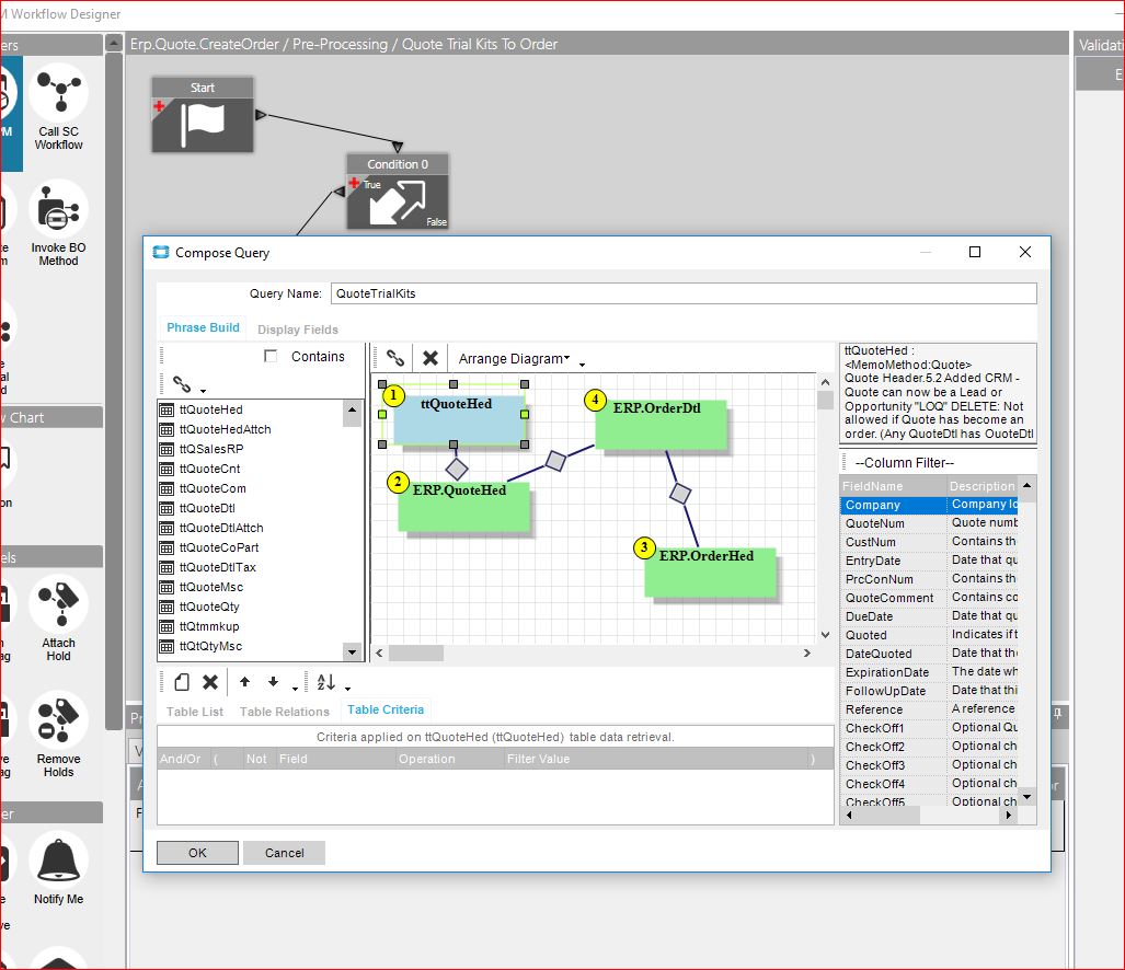

I’m using Erp.Quote.CreateOrder
Condition: ttQuoteHed.Trial_c has been changed from any to another

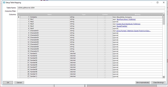

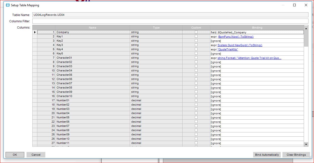

Fill Table By Query:
Use the QuoteTrialKits query to insert data into the UD04LogRecords.UD04 table with configured mapping

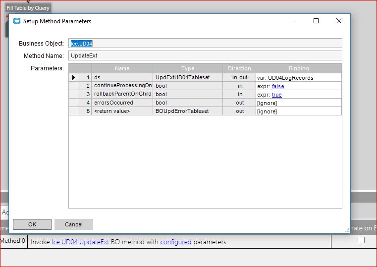

Invoke BO Method:
Invoke Ice.UD04.UpdateExt BO Method with configured parameters

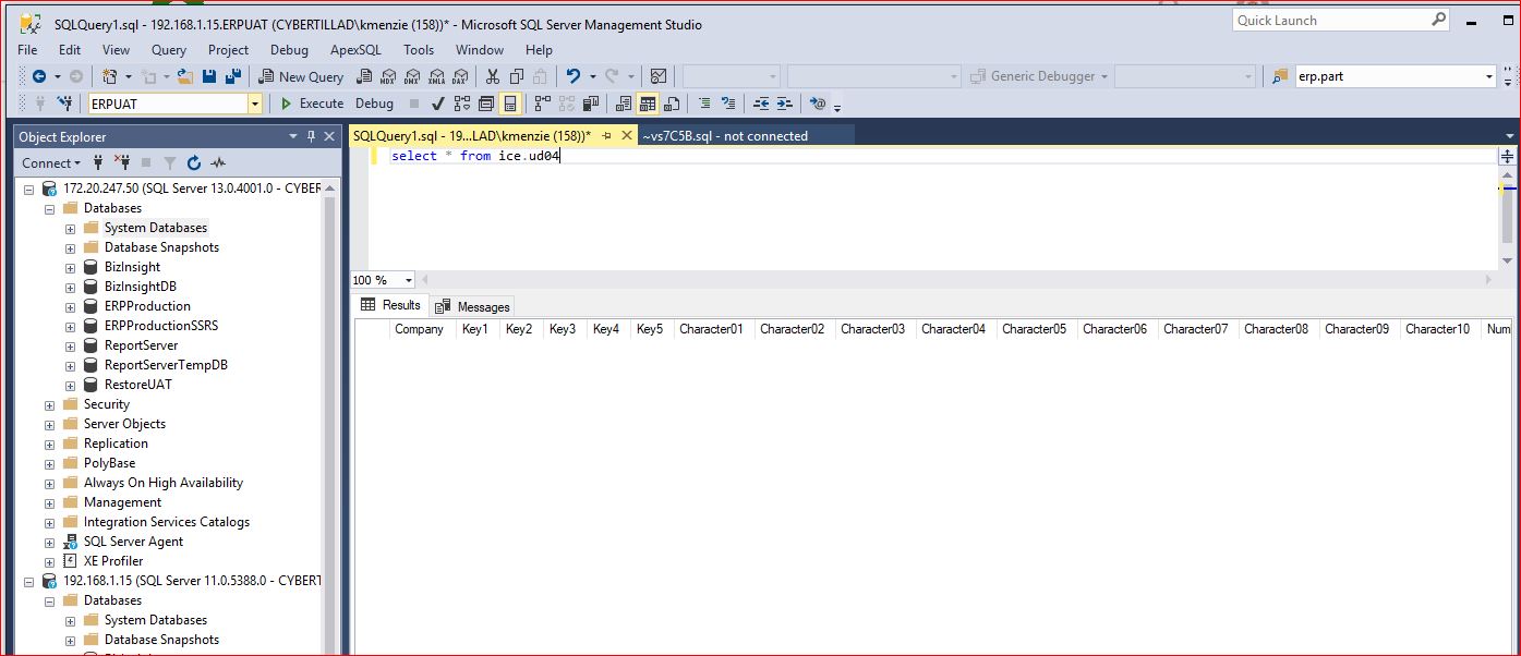

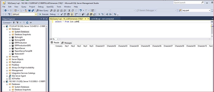

I have tried creating a new quote, ticking the trial checkbox, then converting to an order but nothing is showing up at all in the UD04 table
In the BAQ I thought I would need to select the ttOrderHed table but there was no option to select it.
