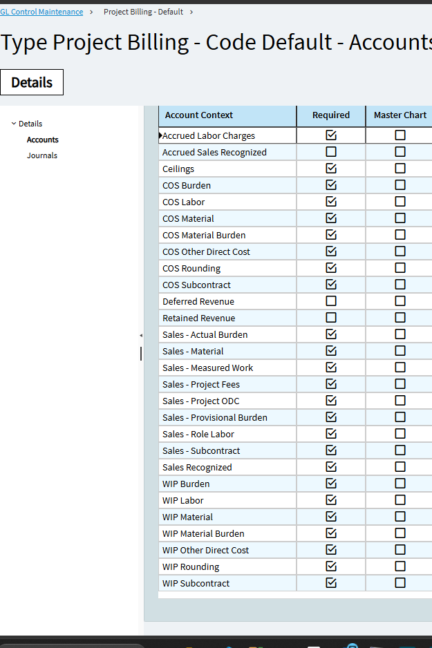

Then, if I understand correctly, when you close a WBS phase job, it uses Epicor’s standard posting rules and will hit the Variance account contexts once WIP is captured. I would have to create a GL control code and put the accounts I want it to hit in those variance contexts. What confuses me is that the Project Billing GL Control Type does not have Variance account contexts:
That makes me wonder if Epicor has its own posting rules for WBS phase jobs, and maybe by default those costs go to Cost of Sales once the job is closed/cleared. I understand I will likely have to test it out to get my answers but am curious what other people do as I feel this would be a common problem.

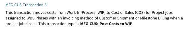

The only thing I ever saw is in the Job Costing Technical Reference Guide:

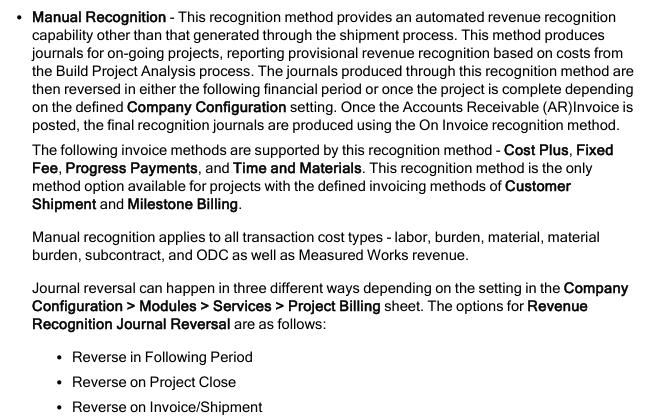

And if you do Manual Recognition, there is a setting to reverse the entry (Project Management User Guide):
Thank you, Mark. I had not seen that yet. Since we are not invoicing WBS phases, I will have to continue to test to see how the costs flow.
