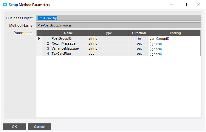

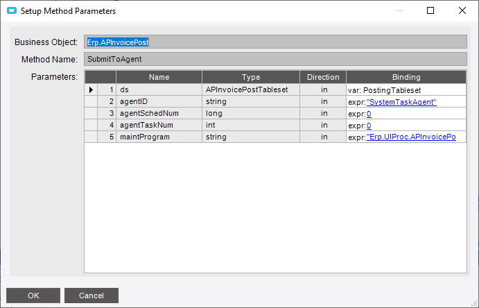

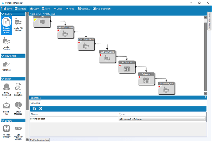

We did this through a function (although this hasn’t been fully testing and still hasn’t been moved to our production environment). The flow I created is as follows:
  1. Set your function to have an input variable for the GroupID.
  2. Create a APInvoicePostTableset variable.
  3. APInvGrp.PrePostGroupInvoices
  4. APInvoice.CheckGroupTaxID
  5. APInvoicePost.GetNewParameters
  6. Set the GroupID of the Tableset to the GroupID input parameter.

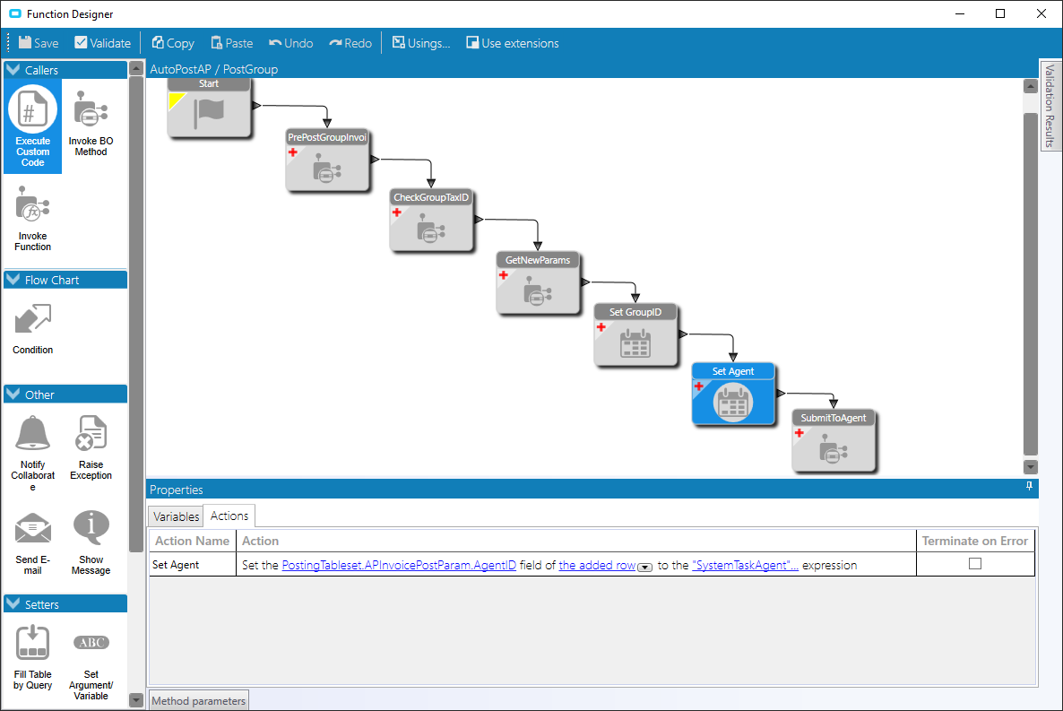

  7. Set the AgentID of the Tableset to “SystemTaskAgent”.
  8. APInvoicePost.SubmitToAgent
We also have another function which we use to create a list of groups that meet certain criteria and then run the previous function on that list of groups.
Like I said this hasn’t been fully tested and some of it may not work or may be unnecessary.

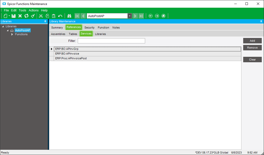

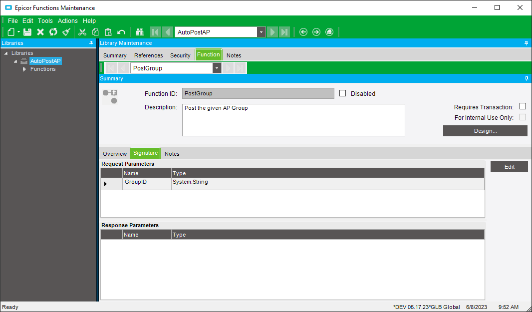

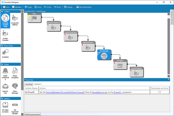

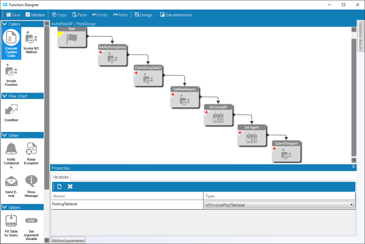

@Ross.Fireball.Kuiper, could I ask you to post the Function here? I am brand new to writing them, although I’ve written BPMs in 8/9/10…

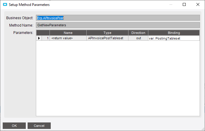

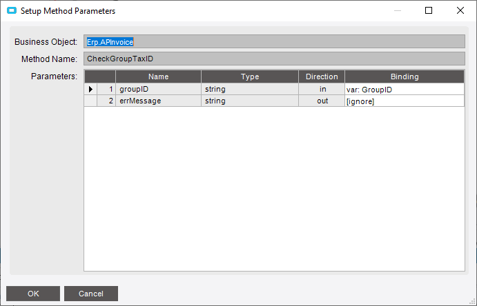

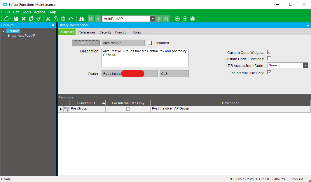

I have it set up like a BPM although you can choose for it to be just code as well.
You can see for some of the business objects I ignored a lot of the outputs, you can use those for error handling and such, but we haven’t implemented that for now.
