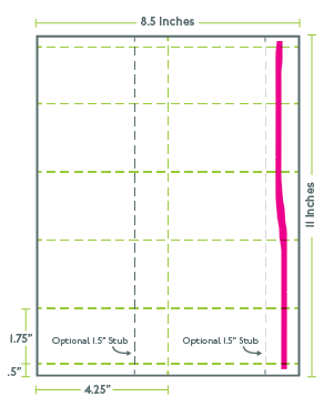

The tag itself was printed twice on the sheet, once on the left and once on the right. The right tag had a red vertical bar on it. When the tag was counted, we pulled the right side of the tag off and used it for tag entry. The red bar would stick out to make sure all tags were pulled. It was very much in the style of the carbon-copy tag but side-by-side instead.
