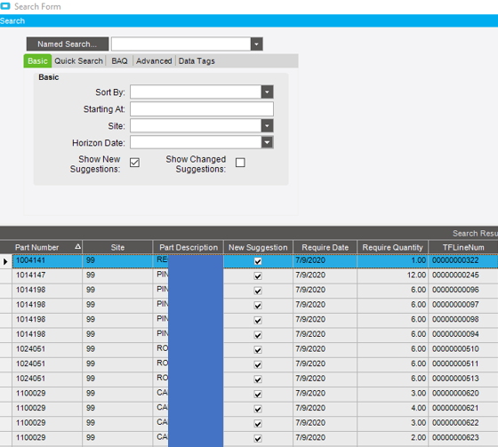

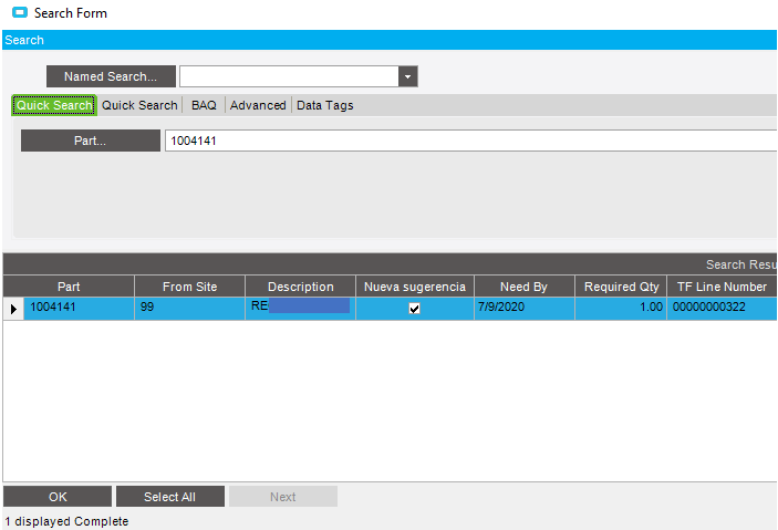

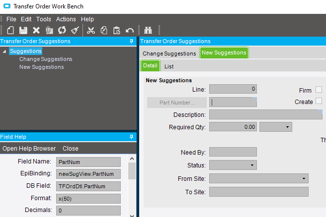

I am trying to use a quick search in Transfer Order Work Bench but when I select one of the registers, it doesn’t display results in the New Suggestions tab.

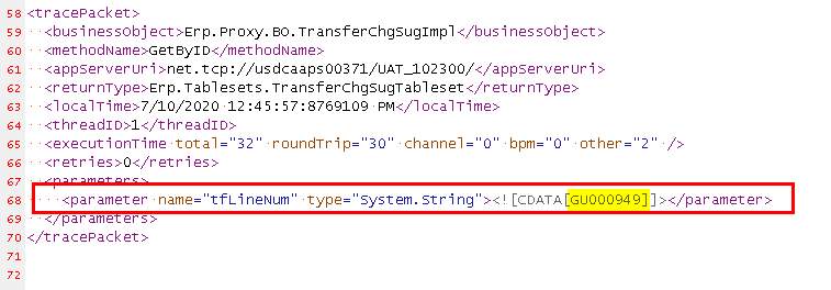

Hmmm … when I do a trace the returned value from the selected record in the search is the TF Ordernum, not a line number (even though the var name is tfLineNum

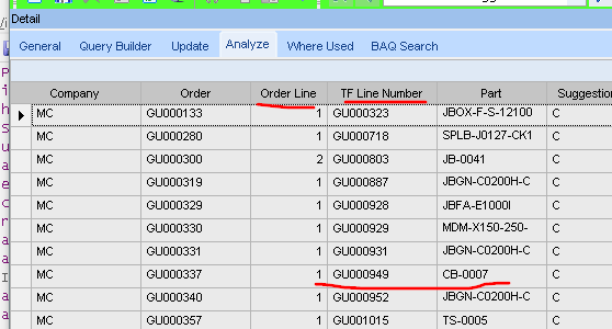

The following is a BAQ of my TFOrdSug table. When I retrieved the record for the TO for partnum CB-0007, the trace showed that GU000949 was the value returned from search.
If my BAQ uses the TFOrdSug table, my quick search will only display Changed Suggestions. I need a quick search that displays new suggestions, that is the reason that my BAQ uses the TFOrdDtl table.
