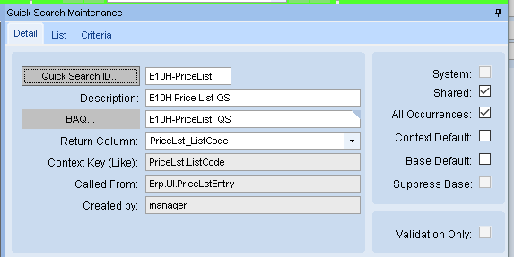

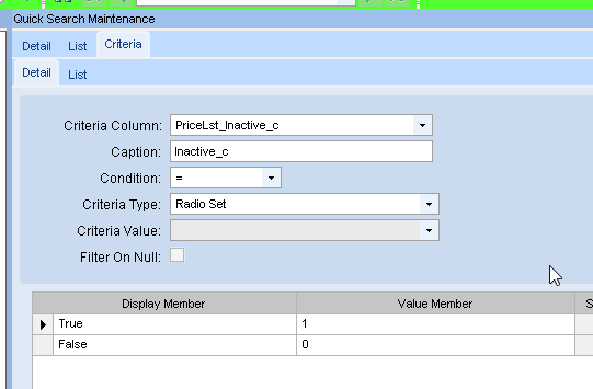

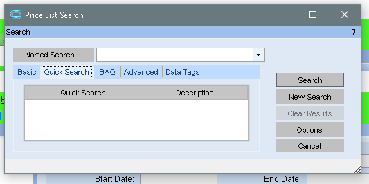

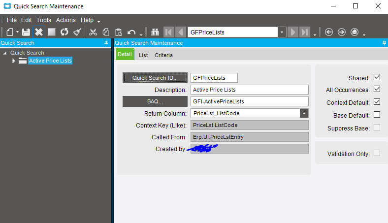

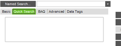

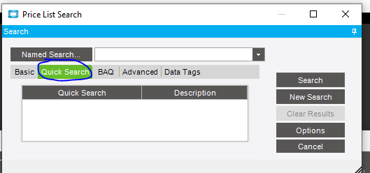

I already review the Ice Tools tech ref guide about quick searches and played around with all the different options (at least I think I did), and still my quick search doesn’t appear in the Price List Entry>Price List Search> Quick Search tab (see photo below). I will also show how I have the quick search set up. My thought is that the “called from” object needs to be changed? Not sure… It shows up if I look in context menu, but why wouldn’t it show up in the quick search list?

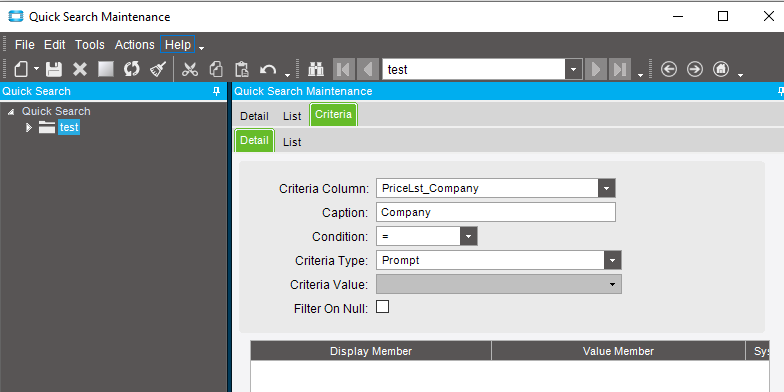

Did you add search Criteria in Quick Search Maintenance?
Yeah Company = prompt

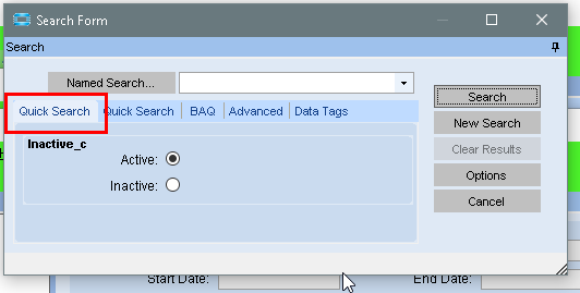

    And it works, choosing the Price list from this Open With … initiated search window, loads it into the Price List Maint form.
  6. Clear the Price List Maint form

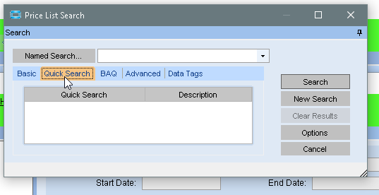

  7. Use the search button and switch to Quick Search tab to see:

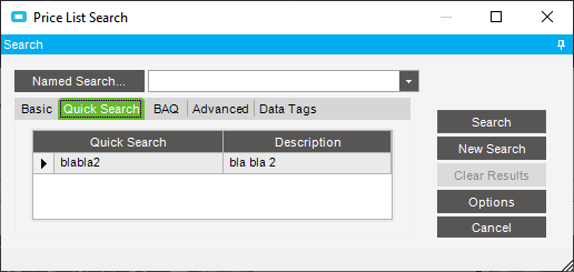

Apparently the PriceLst Search button is special… it doesn’t look for PriceLst.ListCode but instead it looks for Quick Searches related to PriceLst.ListDescription so build your QuickSearch on the Description… not sure if you will be able to select it.
I think the PriceList Form is a bit messed up.

I can’t get the QuickSearch to appear when I click the button to search:

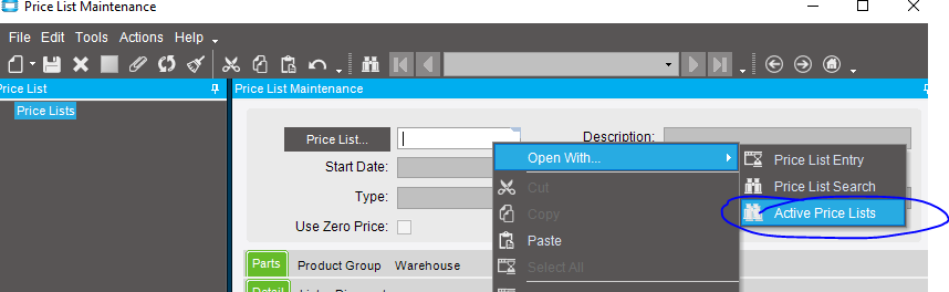

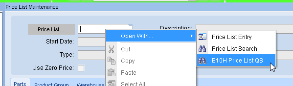

But if I right click the field and use Open With ...,
I can can search with that QS
Note that it becomes the “base” search
And very important for those doing tests…
The QS won’t show on the “Open With…” if it doesn’t have any criteria defined. So if you are just experimenting to see how the settings like Shared, All Occurrences, Context Default, etc… affect the QS, not having a criteria is what keeps it from showing on the “Open With …”.
If you make a QuickSearch on the Description it will show-up :slight_smile: I say its a bug.
I noticed it was looking at the description as well. I am assuming it is a bug.
Will probably call Epicor on it. Thanks @hkeric.wci
