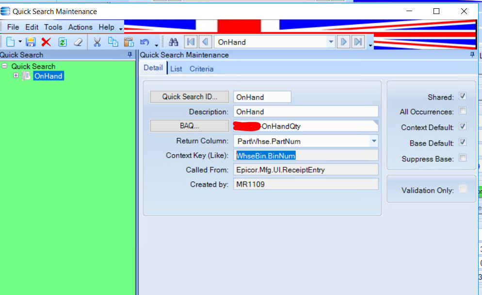

Referring to the screenshot below…(in the process "receipt entry)
I clicked to the right of the word BIN and selected quick search entry.
I filled in the pop up box to the right of the screen. Tested the results and clicked save.
When i click the word bin and go to the quick search tab, shouldn’t i see the quick search listed in there?

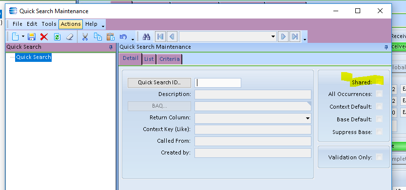

What does your Quick Search Maintenance screen look like? Did you click shared?

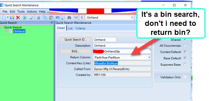

Hi Mark,
You say you are doing a bin search, but you are doing a PartWhse search. I think this might be your problem.

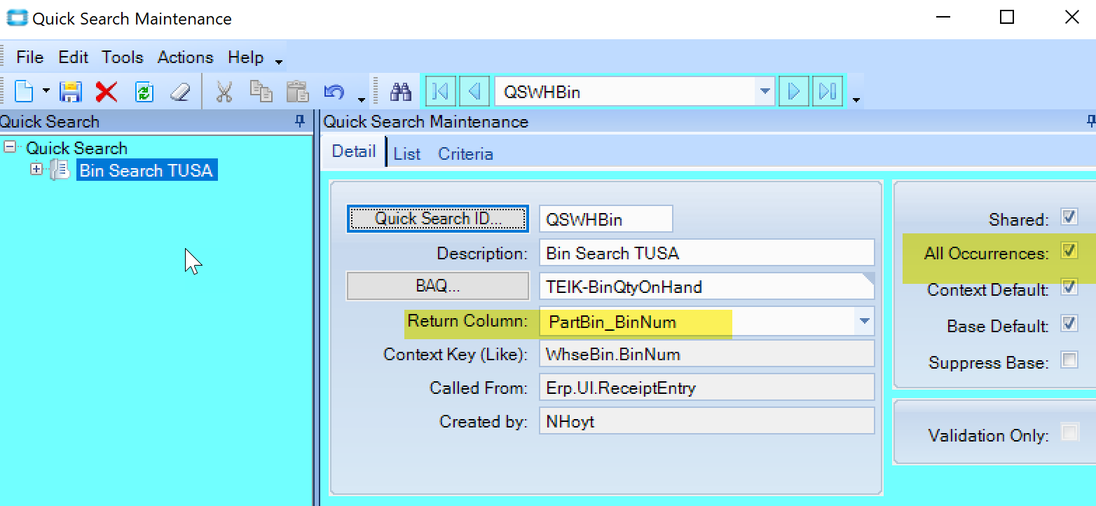

Here is one of mine. @Nancy may be correct…

so somehow i need to change the context key? in the QS criteria? to just bin search?
I can’t seem to be able to edit it

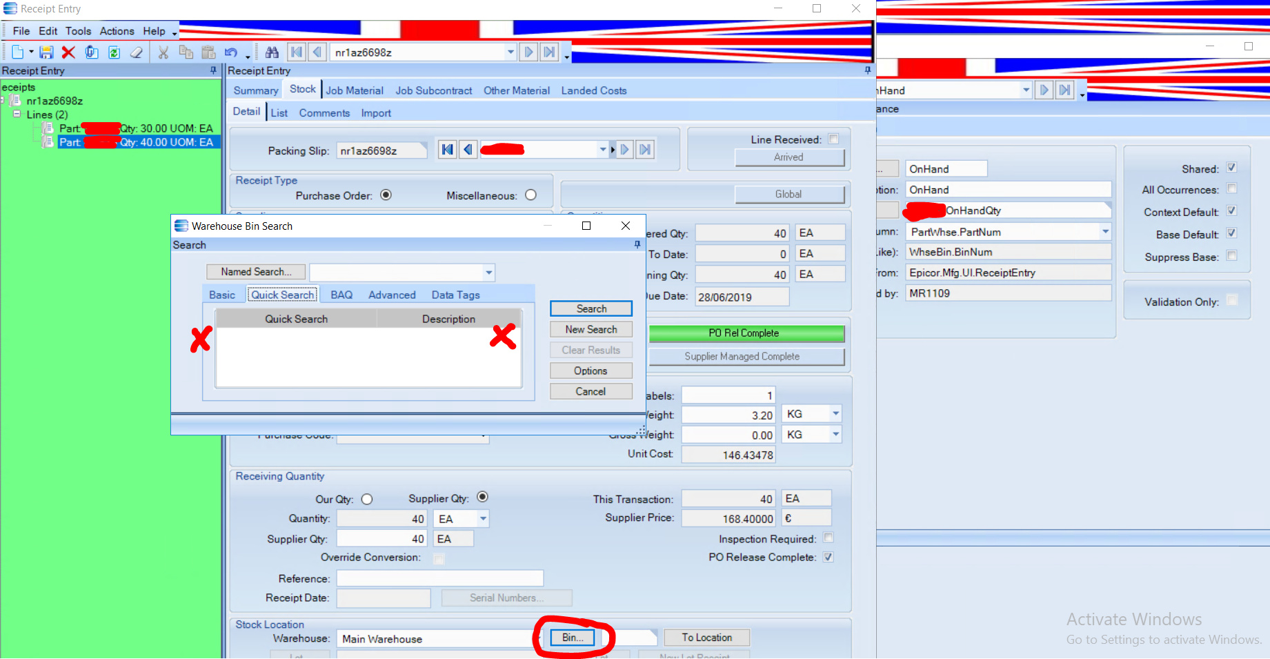

look where its appeared?!

Huh. And if you click the one above it, Warehouse Bin Search, it doesn’t show up under the quick search tab?
Nancy
(Nancy Hoyt)
May 9, 2019, 2:09pm
10
Frankly Mark, I like it better where it’s showing up in the Open with.
BTW I tested in our db and I get the same strange behavior. I even clicked for the QS to show up in “All occurrences”. I get it on the Open with but not in the expected QS tab (10.1.600.20). I am returning BinNum too, per below.

well, open with is good enough for me!
Thanks for your help its much appreciated, thank you.
