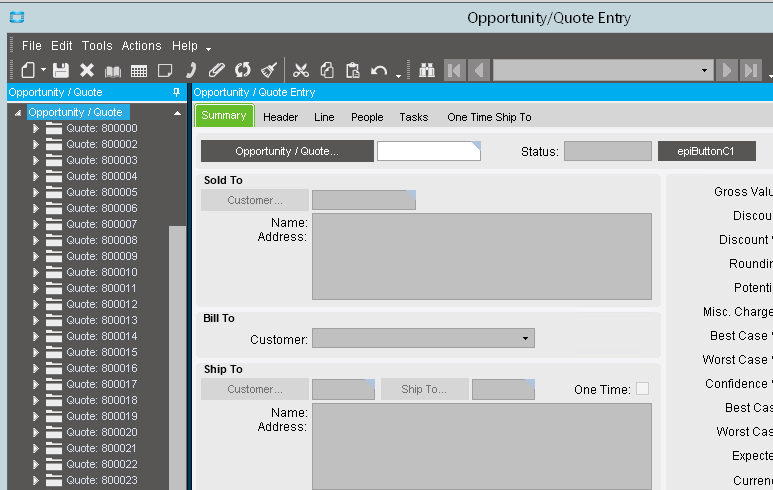

Create a new button to use instead of the native button.
On a button click event, set a BPM data field to some number. Then, mimic a click on the native button. Code is below.

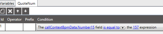

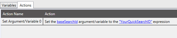

Create a Post Processing BPM on QuickSearch GetBaseDefault. Have a condition that checks that the BPM context field is set to the value your button sets it to. If yes, set the result parameter BaseMenuID to your QuickSearch ID.

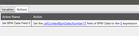

Then, reset your BPM context field to 0.
private void epiButtonC1_Click(object sender, System.EventArgs args)
	((EpiDataView)oTrans.EpiDataViews["CallContextBpmData"]).dataView.Table.Rows[0]["Number15"] = "157";
	EpiButton btnKeyField = (EpiButton)csm.GetNativeControlReference("14f4b126-b1cb-4045-8690-614eeda743ca");
	btnKeyField.PerformClick();

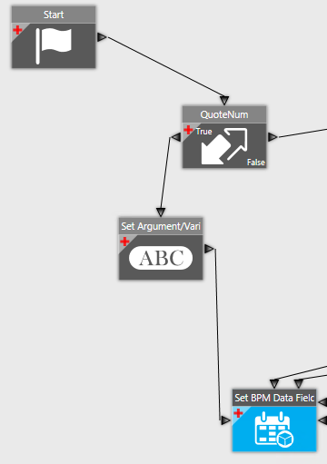

Sure thing, do a post processing BPM on Ice.QuickSearch.GetBaseDefault. Then the screenshots of the BPM are below

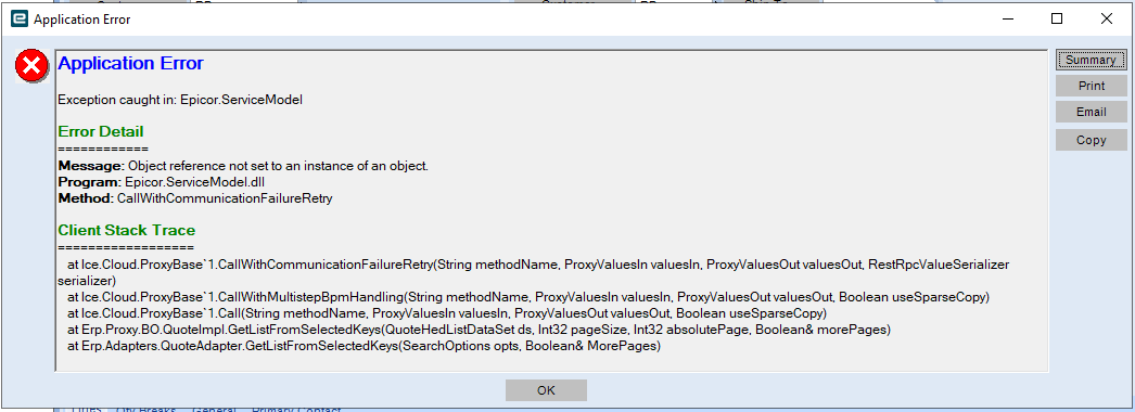

Was wondering if you’ve ever seen the following error message when selecting multiple Quotes from the quick search (this happens to me even without the customization):
