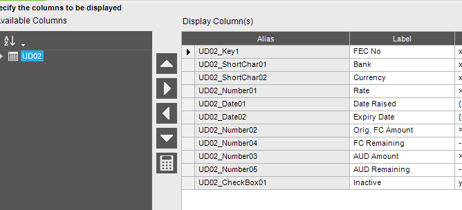

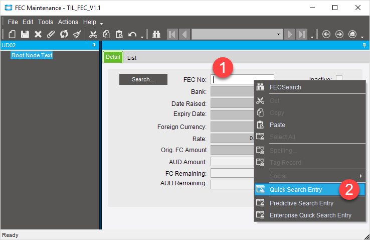

I changed the default search on the UD02 form in the Quick Search dialog. Posting the steps for completeness
The BAQ in quick search returns column Names “Currency” and “Inactive” The default search returns column names ShortChar02 and Checkbox01… Using the code in its current state (using ShortChar01 in the where clause and having the Quick Search set as default appears to ignore the where clause. Reversing the scenario i.e. using the where clause with “Currency” and not setting the Quick search as default will through an error as the it appears to parse the where clause, because the column names don’t exist in the output.

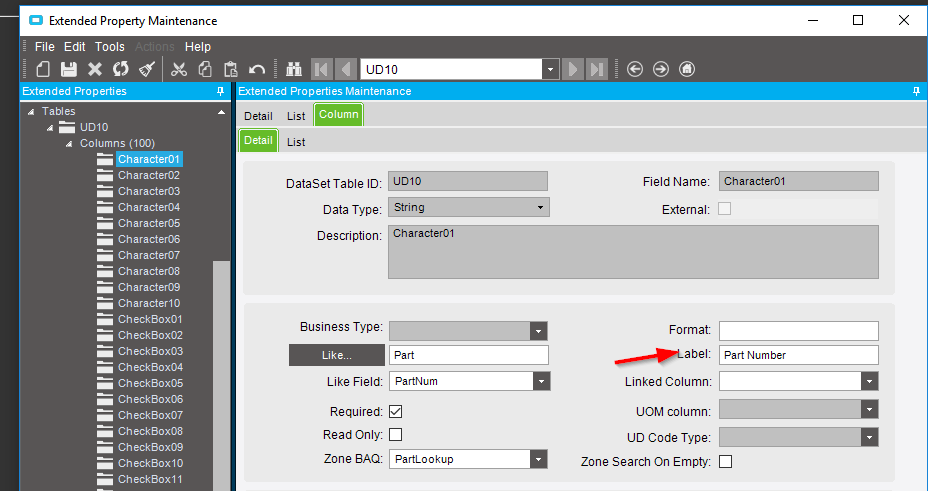

But did you change the label in the extended properties on the UD fields? I think that should change the label on the column head for the search. That’s what I did for UD10 (and others)
Thanks for your reply @Banderson. Your post prompted me to recheck, and I did have labels setup for the fields, but my Currency Field was labelled “Foreign Currency” so I changed that to “Currency” but no change in the behavior.
Interestingly when I look at the BAQ I see the alias names of the column as UD02_Key1 etc.

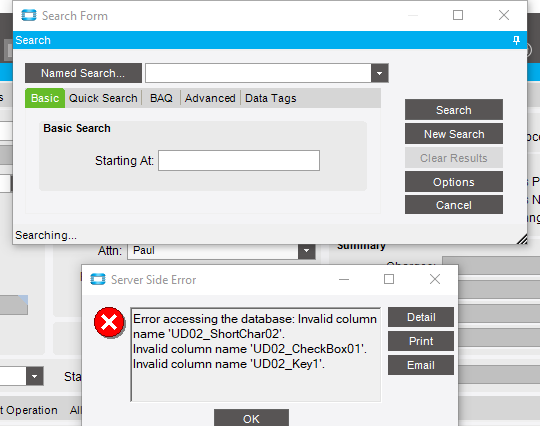

Do you column headings in your code need to be “UD02_ShortChar02” etc. I don’t think you can just use “ShortChar02”. (or does the adapter do that for you???)
Does your search return a SysRowID?
I thought I’d tried that previously, I just tried again changing the relevant fields in the where to UD02_ShortChar02 and UD02_CheckBox01. No change unfortunately. Anyway like I said when I rework this post a solution.

Hmm looks like had some caching issue with a named search. I have finally got rid of that and using UD02_ etc in the where clause I am getting an error. So I am going to alter the where clause again and see what happens.

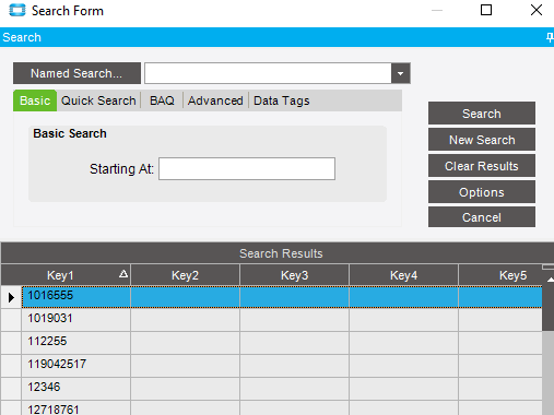

Ok so that functions correctly however the base search returns a mass of columns that don’t match with the labels setup in Extended properties. How do I get around that? The reason I wanted to use a BAQ/quick search was so I could get just the rows I needed and have the column names display correctly and if I was to use a named search I could just have the search form popup without the criteria.
