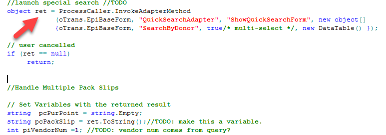

I’m looking for a solution to return multiple values from a quick search that I am calling.
My quick search returns the PackingSlip from a Receipt Header.
I am currently calling the quick search like so:
It appears that the return type is an ArrayList, but this is defined by the quick search itself.
I would like to return both the Packing Slip and the Vendor Num, which are both available in my BAQ…
