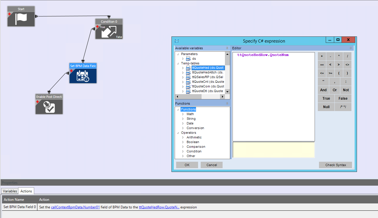

Can you tell me where you’re getting setting your number01 variable at? I bet we need to verify it’s being set correctly
Hi Aaron,
I’m setting number01 in the pre prossesing directive, like this
Regards
Adrian.

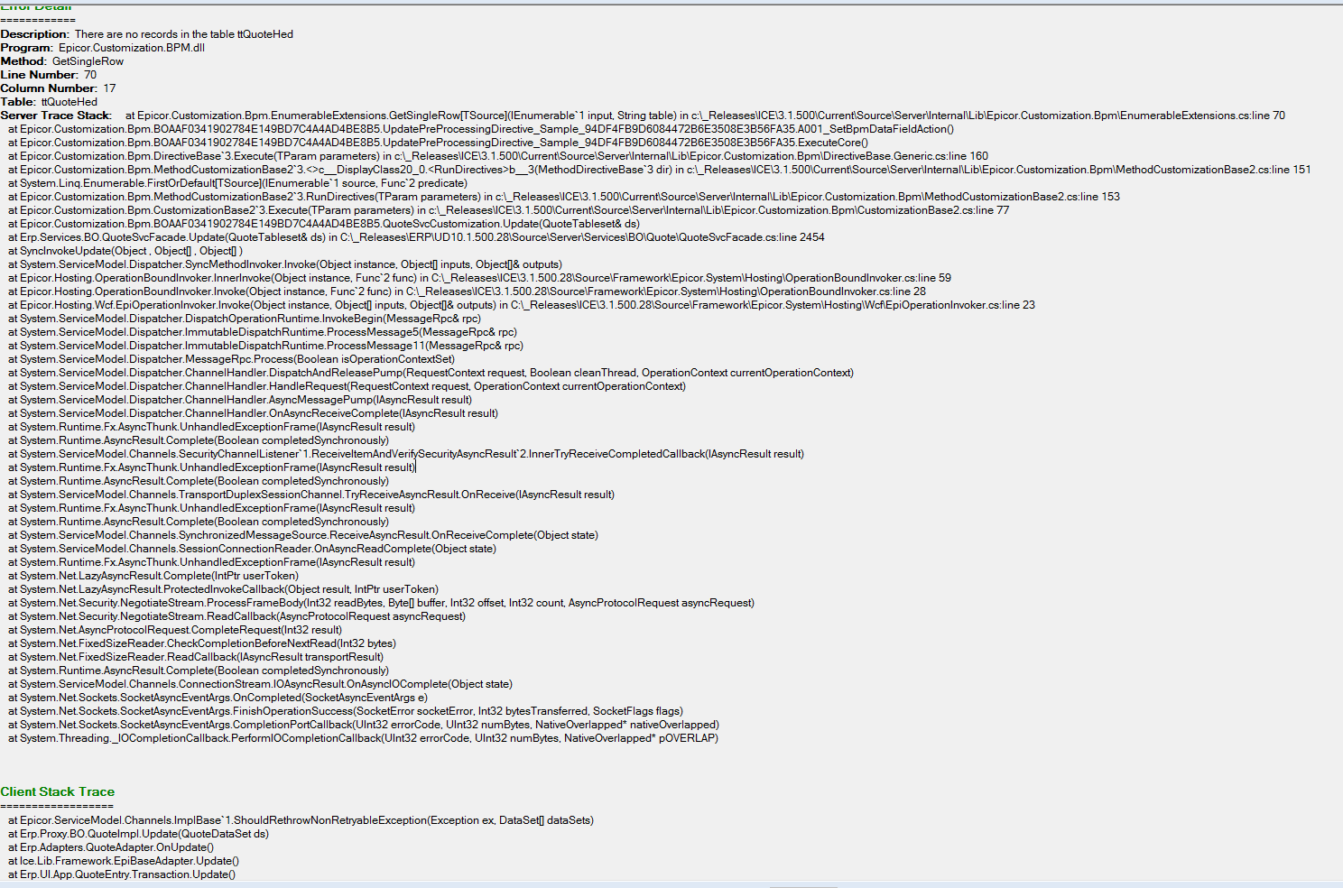

Can you verify the location of the bpm exception? Is it happening on the pre processing or post? If you expand the error message it will tell us more
Here is the error detail
Regards
Adrian.
Oh boy. Can you do another test and hard code in your quote num value into your post processing code? I could be wrong but it almost looks like the issue is that the quote form you’re in is missing a dataset. Can you also try getting all the way out of the quote form and back in and then running the test (not the hard coded test)?

Can you try setting the BPM data field before your conditional block?
Still got the same error Aaron
Sorry Adrian, I’m not sure why that’s happening. It’s clear that the temp table value is empty, and we need to get QuoteNum from somewhere. I have a BPM that is very similar to yours and I set my variable exactly like do you without issue. @josecgomez any ideas?

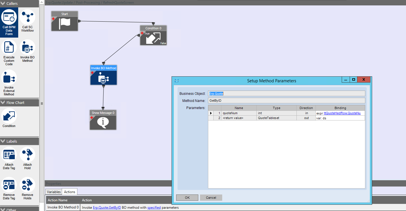

Can you put a screenshot of each of your nodes in the Pre-Proc and post proc
Also what are you doing to trigger it

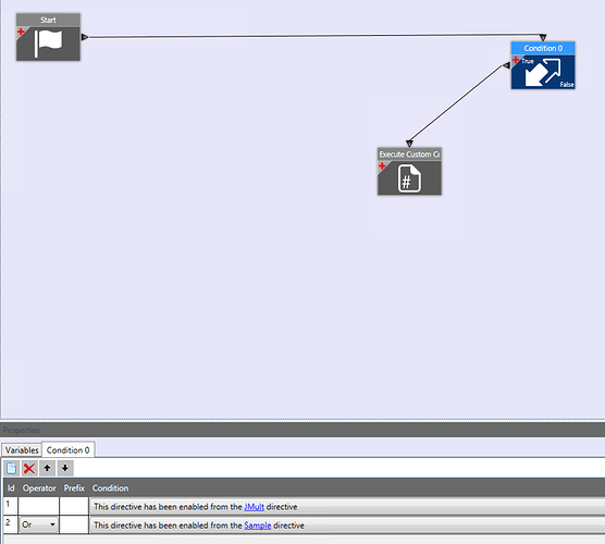

Here is a bit of info on what I am trying to do. If a sales rep has a sample account or a customer orders a sample, there is no charge for the item . So, I have used the QuoteDtl.AnalysisCode field to identify this. With a user code entry of ‘SMP’
The condition on the pre processing is like this,
This is because it can either be a sample account or it can be selected as a sample on an ordinary account.
The condition on the post processing is as follows
In the case of a sample the price should be set to zero this was working but not without a manual screen refresh.
Hopefully what I’m trying to do is a bit clearer now.
