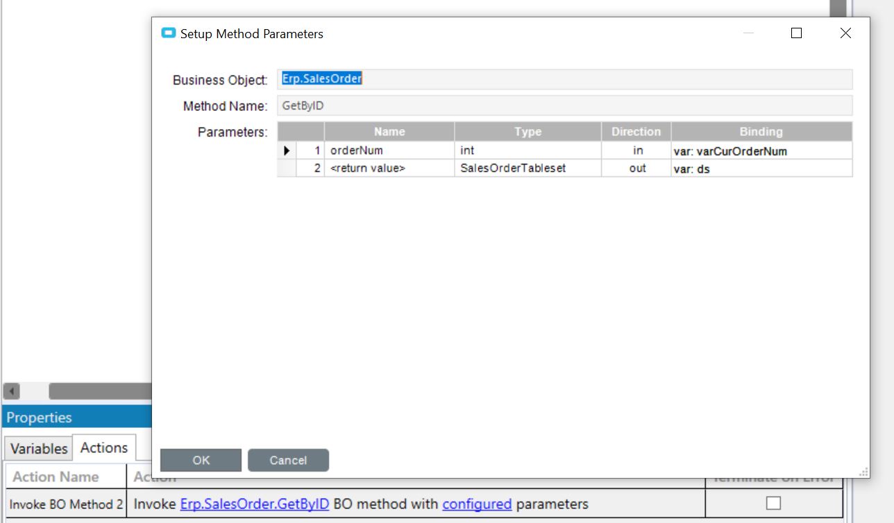

thanks for the reply. I’m trying to do this as a widget, post processing, SalesOrder.MasterUpdate. I’ve added a BO for SO.GetByID as shown. Is this configured properly?
Mostly, yes, however, one of the arguments for MasterUpdate is the Order Number (iOrderNum I believe). This would be better to use for the binding.
