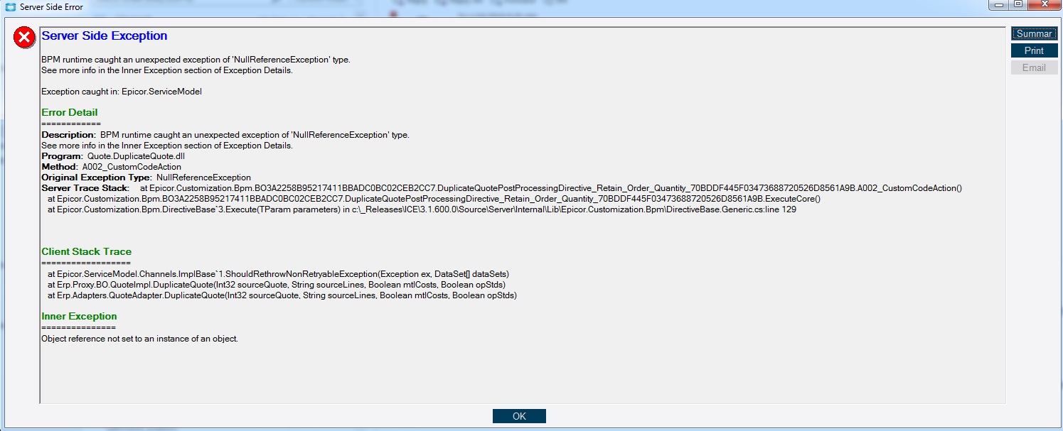

This is maybe a long shot, but using the solution above I was able to use this BPM and get the order QTY’s and some other fields to copy over upon duplication. Our company utilizes sales kits on some quotes, once a sales kit is introduced to the quote the BPM returns an error. Attached below.
Since i’m not extremely code savvy, i’m wondering if anyone has solved this issue or has any suggestions on how to deal with sales kits using the above BPM expressions.
Heyho
Are you sure
var dbqt = Db.QuoteDtl.Where(p => p.Company == tt.Company && p.QuoteNum == tt.QuoteNum && p.QuoteLine == i+1).FirstOrDefault();
is filled when trying to update? Try to recreate the “Where(p => p.Company == tt.Company && p.QuoteNum == tt.QuoteNum && p.QuoteLine == LineNumber” in a BAQ.
Did you change the code? If so, post it here ^^
