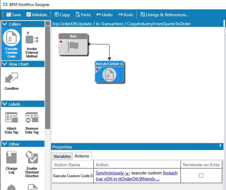

I am using @timshuwy 's code here (modified for my UD field). I am trying to apply it to a Data Directive In-Trans BPM (on Erp.OrderDtl.Update). I get an error regarding an anonymous type (see attachment).
CustomCodeError
I am a novice, trying to learn. Can someone help me identify the error?
