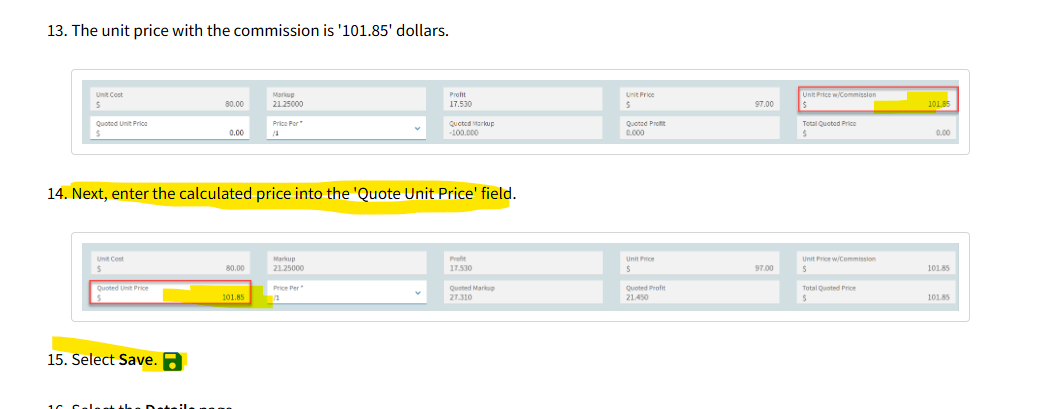

I think this is what i was looking for:
We kept getting confused because that field was disabled for us. I think it works well in new quotes.
