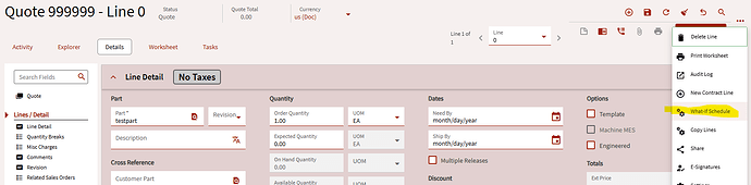

I can see it at the quote line details in the actions menu:
If your quote is approved this will be disabled.

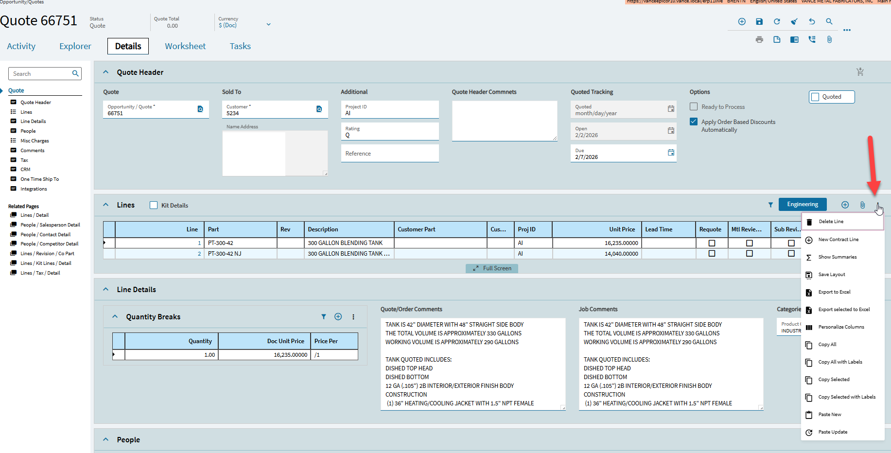

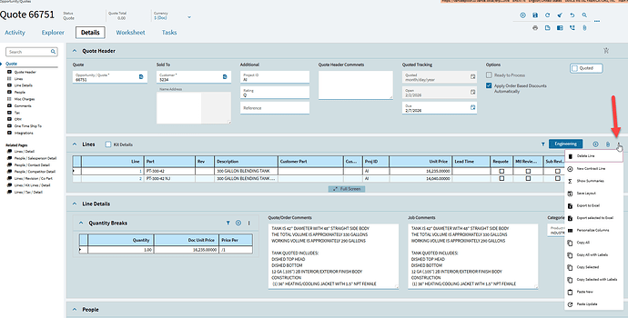

We needed to click on the Lines/Detail page in order for the overflow pull down to include that option. We are able to do all of our work from the main quote header page so that is where we were looking for it.
Is there a way to get this option added to the quote lines card?
